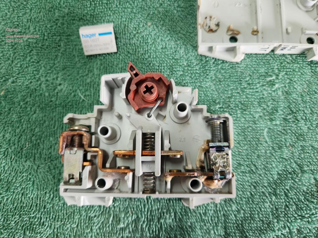

I grabber a circuit breaker from my junk pile, for a project I'm working on. Its a HAGER 64Amp breaker, and was measuring open circuit in both positions. To see if it was a quick fix, I drilled out the factory rivets to look inside.
Looks like the terminal on the right wasn't secure, got hot, and melted the plastic, letting the contact inside get out of contact.
But isn't something missing? Where's the mechanism to trigger the circuit breaker? This has never been apart before, is it a fake HAGER breaker?

The model number indicates it is a switch, not circuit breaker.
  catalogue said  Hager SB163T 63A Modular Switch with Red Toggle.

Well there you go. I assumed these were circuit breakers. Probably lucky it was faulty, I may have used it in a place where I needed a breaker.
I guess technically it is a breaker.

Yep that is just a main switch. The only way to tell sometimes is to look at the symbols on the side, if they have an x on one end of the moving armature in the diagram they are a circuit breaker, otherwise they are a main switch

1. Before you burn down the building, one should always decode any brand of din rail product via Manafacture code document,to identify exactly what it is!
This breaker vs switch is for the unaware and very common falocy purely taken for granted. I have seen numerious dangers not just from Hager brand.
A French electrician I used to work beside made this very mistake in two storey building, fitting a 3~ 63Amp he thought was breaker from mains supply to upper sub board. Anything wrong? See if this gives you the hint....
Big QUESTION,
2. What IS a circuit breaker used FOR? To protect....what? You'd be very surprised the answer.
3. Symbols? Yes. A 'squiggle' inline of the switch symbol usually makes it a breaker, no squiggle is NOT a breaker. Again always get Manafacture document as the symbol is often drawn diffrently per brand country!
