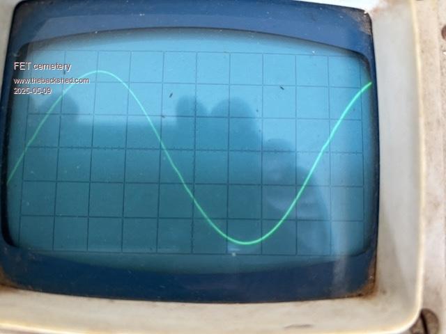

Ordered some physically smaller resistors, will assemble my second power board with them. The 5 scope traces I posted yesterday are pretty much what I would expect with everything working properly, it's only the addition of the big toroid that makes things go sideways. Switching noise going where it shouldn't has to be a possibility. No stone unturned, no FET unburned. |

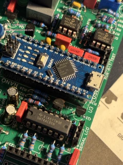

FET cemetery Regular Member ![]() Joined: 17/04/2024 Location: AustraliaPosts: 67 |
The components you mentioned are all correct, just wondering if I've got this right? ![]() 74AC86 into 33R resistors on the nano board then driving the 120R's on the power board. No stone unturned, no FET unburned. |
wiseguy![]() Guru ![]() Joined: 21/06/2018 Location: AustraliaPosts: 1206 |
Yes that's correct total of ~300R and voltage of ~ 3.5V (voltage after LED forward voltage drop) so current is ~ 12mA. When you assembled the controller, did you check the CBE orientation of the TO92 plastic cases. Some substitutes have a pinout of EBC instead of CBE and need to be inserted 180 degrees from silk screen (this is also true for some substitutes of the TO92 FETs). I am guessing you are aware of this? Also try reducing the output voltage with the trimpot to its lowest setting ie 200V or whatever lowest setting is and when/if it appears to be running/idling well then advance the pot for more output volts - maybe there is a threshold where it goes bad? (assuming using batteries) My preferred method of testing is to connect variable voltage/current power supply (when it arrives) only to the FET power PCB. Put the controller link into test mode. Power the controller from a separate 12V 250mA supply. Now with variable power source set to 1A slowly wind up the volts from zero and note for every volt in you get ~ 6V out on the 240V winding. Power should start to rise in a linear fashion free from weird noises except a slight hum (dont advance too fast or it will be a louder hum until it settles). Note, leave feedback off until you get a nice stable 240V at say 40V or whatever DC this occurs at. Remove test link momentarily at this point and replace it so the PWM ramps up and check it is well behaved. Now advance the input volts by ~ 3V and connect the feedback voltage and see if it now regulates ok and ramps up ok. Until you get this right, don't use more than 1A. I actually usually start current limit low ie 100mA and as it current limits with advancing volts then increase current by another 100mA etc. That way you can sneak up on any issues with minimum applied destructive power. Edited 2025-05-12 02:13 by wiseguy If at first you dont succeed, I suggest you avoid sky diving.... Cheers Mike |

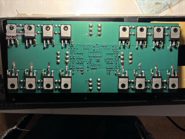

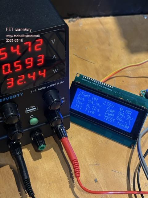

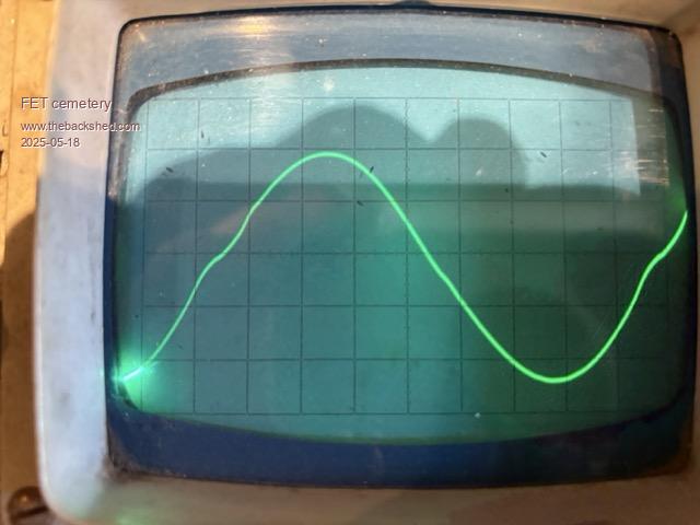

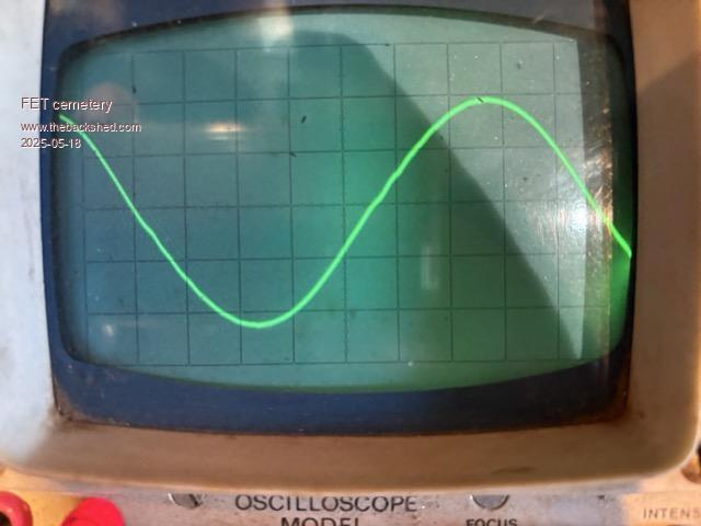

It really does help if you have the right test equipment. The power supply arrived last Thursday as did the smaller gate resistors. I fitted the fets to the second power board with the smaller resistors. Following Wiseguy's test procedure everything checked out ok on the bench with both boards, hooked up to the toroid and all was good (both power boards and both nano boards were tested and all worked). I guess it must have been an unstable supply coming from the batteries and light globe or fuse when loaded with the toroid after all. I'm happy to be the village idiot if it saves someone else from making the same mistake! Eventually wound it up to 54V in, 235V out, this is with the nano board and fet board powered by the variable supply: ![]() The transformer makes a nasty hum if the voltage is wound up too fast but settles down pretty quickly. Waveform is ok. ![]() Couldn't help myself, I hooked it up to the house battery with a 32A breaker on the DC side and ran a 1kW heater for 20 minutes or so, bit of a hum from the transformer and the waveform wasn't as pretty but this was using the power board with the big resistors and some fairly untidy wiring that could easily have been picking up switching noise. ![]() The bias supplies and regulators were slightly above ambient, 5 degrees or so, nothing else was even remotely warm. No air movement, power board lying flat with the heatsink underneath it. Efficiency was a whisker under 95%, take away the 30W standby power and the conversion efficiency is nudging 98% at 1kW. Impressive! Time to build a cabinet for it and wire it up properly. Thank you to everyone who has helped me get this far! No stone unturned, no FET unburned. |
KeepIS![]() Guru ![]() Joined: 13/10/2014 Location: AustraliaPosts: 1864 |
![]() ![]() NANO Inverter: Full download - Only Hex Ver 8.1Ks |

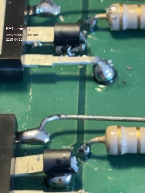

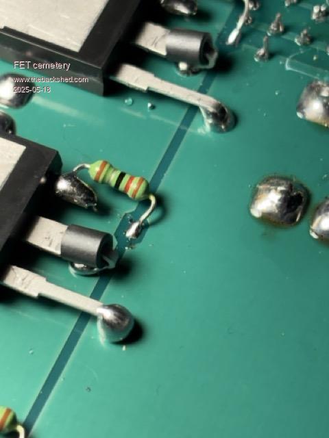

Yep the PWM does seem a bit low but it'll be spending a lot of time over 5kW so will leave it for now and see how it behaves under load. I used a different technique soldering the fets on the second board: ![]() The drains and sources were soldered from the component side using the unregulated 80W iron. The fets were pushed up against the heatsink to keep them cool, and the iron was held on the leads for 8 to 10 seconds, getting both sides of the board hot enough for the solder to melt all the way through: ![]() I'm pretty happy with the result, will do the same to the first board when I swap the gate resistors. No stone unturned, no FET unburned. |
