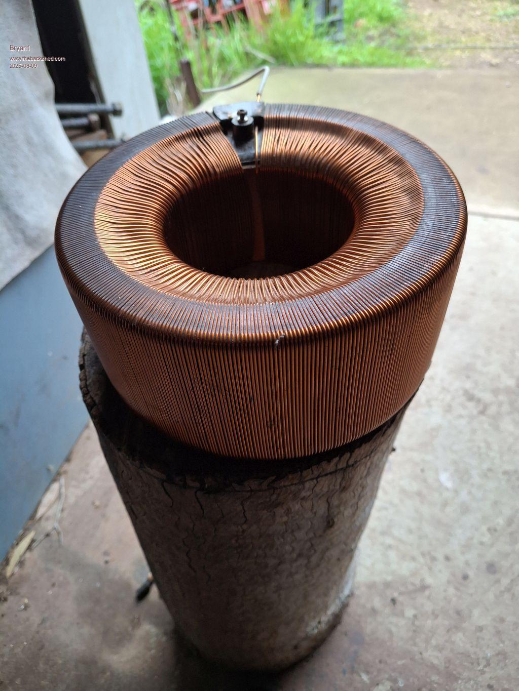

G'Day Guy's,
           Well I took up this toroid to Rogers this morning to get an opinion and due to the weight of this he did say it say it could be suitable. Basically he mentioned I will find when the wire is is off along with all the tape it will be tightly wound coil of very thin silicon steel.
Now this toroid came out of my old Variac and when I say old I can remember seeing Dad using this before I was a teenager. So I reckon this one is from the 50's or early 60's where the poms made things right.
Now as I have 2 spools of 1.6mm wire I'm thinking winding a 2 inhand secondary but how many turns is the unanswered question.
Now one may ask why go 2 inhand of such thick wire well this toroid will going on my first Madboard which will be coupled with a 5Kw Goodwe gridtie and 6Kw of solar so the back feeding rate is going to be pretty high.
Tomorrow I will strip it down so we can have a look at it and it may be finally time to get that roll of mylar out that I bought 20 years ago.

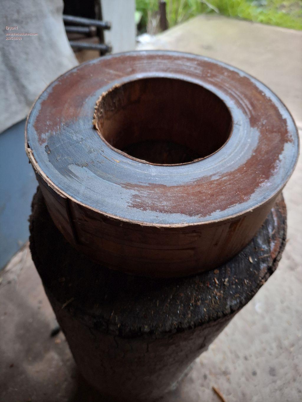

Ok bugger tomorrow was too long to wait   so here we are with a 172 diameter 90mm hole and 60mm high bare toroid
It didn't take long to strip the wire off and a quick tap with a hammer and chisel soon got the bakealite covers off to expose the toroid. Each edge will need to ground so a nice radius is there for the new wire.

Godoh
Joined: 26/09/2020
Posts: 712
Posted: 08:03am 09 Aug 2025
Looks good Bryan, what are the measurements of the core?
Also what guage of wire is on it now?
The last two torroids I made I wound with a high voltage side of 2.8mm sq, wire.
The secondary was flat glass insulated bar of 12mm x 3mm.

Godoh
Joined: 26/09/2020
Posts: 712
Posted: 08:07am 09 Aug 2025
I see you already did the unwind.
That core is a bit too small. It would only be around 1kva at that size.
The last core I would was 172mm OD 100mm Id and 140mm high. That worked out to be around 4.5kva.
Do you have another core or two to stack on top?

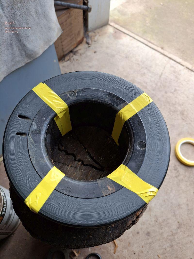

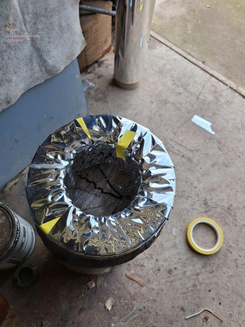

This morning machined the ridge off the top former
Then finally got my roll of Mylar out of the corner and wrapped up the toroid

Bryan1
Joined: 22/02/2006
Posts: 2297
Posted: 07:49am 10 Aug 2025
So I asked Co Pilot the question of 13 turns on the primary at 24 volts for a 240 volt output and we finally settled on 130 turns. Now I said I was going 2 inhand and the reply was yes that will double the current rating.
Now I did ask about winding one 130 turn layer then one ontop after insulating and the answer was NO don't do it unless the length of the 2 wires are exact.
I would of thought the turn would of been closer to 200 but eh I'm still learning and this will be my first toroid rewind.
