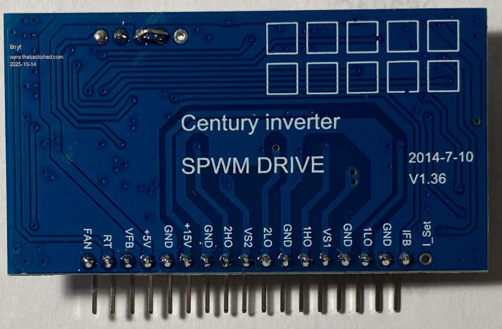

Some inverter boards from aliexpress come with an SPWM module marked "Century".
Even though it is pin compatible with the more common EGS002, it is undocumented.
From testing, the one I received is configured for bipolar SPWM, and I cannot change it. So be ready to swap it out with EGS002.
