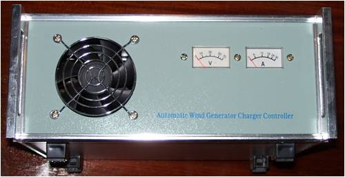

Hey I'm wondering if anyone can shed some light on the operation of those cheap Chinese windmill ( the ones with the noisy fibreglass blades ) controllers. I know the controller is pretty unreliable and dont last very long, but I was wondering how they regulate the output. Is it a shunt controller? If anyone has a pic of the cct board that would help.

I have one here, never used, from my 1KW machine Glenn.
I'll see if I can remember where I threw it and take some pics for you

Posted: 08:17am 03 Jul 2009

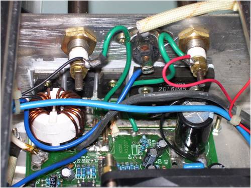

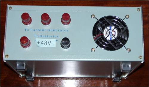

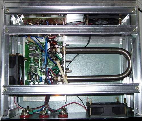

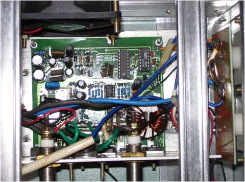

ok, lousy shots, sorry, but here goes. If you want more detail, let me know and I'll try to take some better shots when I have better light....

Thanks for the photos Ross.
I've got one of those circuit boards, minus the bridge rectifier. I think Dennis gave it to me, it was broken. I didn't know it was used for.
The dump resistor is 3 ohms. There's a micro chip, MOSFET driver ic, an awlfull lot of parts for a simple controller.

Posted: 12:41am 05 Jul 2009
Yeah, when I originally put up my mill, this controller was near useless. Got nothing (useful) out of it, so built a simply bridge rectifier (as previously posted here I think), which did infinitely better.
As I never seem to be able to make as much power as I use, there wasn't any need for a dumpload controller here.
If you want more detailed pics of this thing, just holler.
