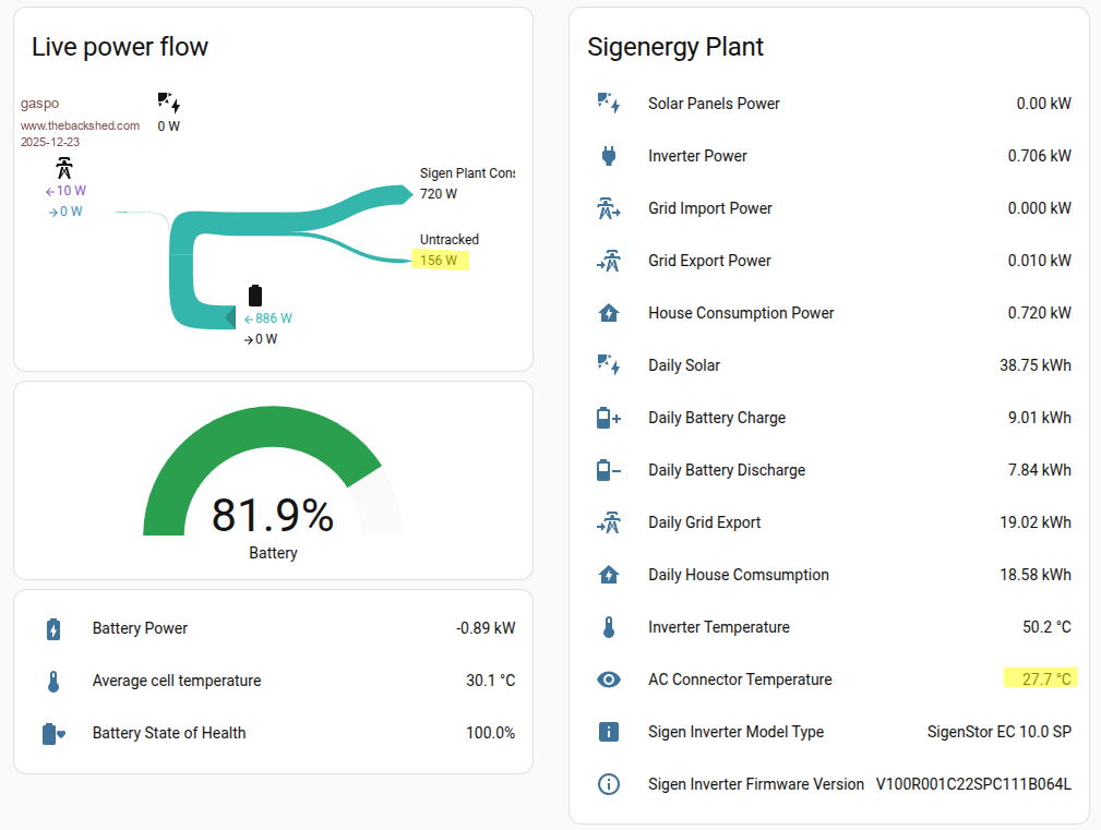

Beyond the mobile app, I use Home Assistant, which pulls data via Modbus over Ethernet (enabled by the installer during commissioning). I’ve also built a simple temperature monitoring setup using an ESP32-C3 and a DS18B20 sensor attached to the inverter’s AC connector. In Home Assistant, I’ve configured an automation to send alerts to my phone if the connector temperature exceeds a set threshold.
The battery cell temperature generally sits around 30 °C. Overall system self-consumption ranges between 150 and 200 W, averaging roughly 170 W.

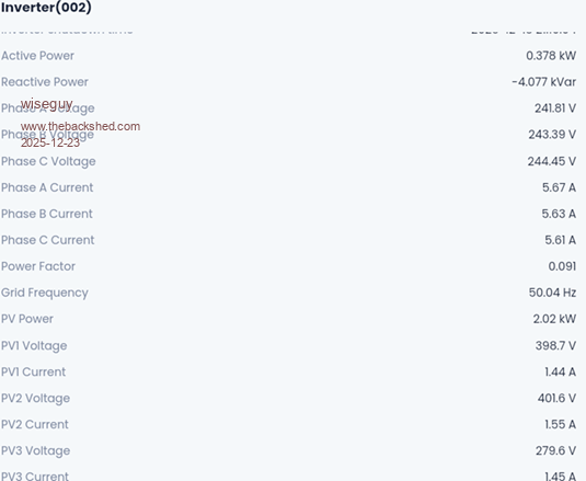

This morning I took a look at the inverter data page and noticed some weird information. Maybe Gaspo (anyone?) can tell me what it is up to, here is the page;
The house load was about ~380W at the time yet phase 1,2 & 3 all have ~5A of current at ~240V the reactive power was ~4kVAR, reported power factor was ~.091, which when multiplied by the ~4kVAR equates to the ~380W of consumption.
Does this mean that the energy authority is supplying ~4KW of reactive power for my 380W load? I hope so lol its about time we got something for nothing back from them, but seriously if this is correct and there are many installations going in there will soon be a grid problem ? If its true whereas previously home owners are not hit for their reactive power, maybe this will cause change ?
Edited 2025-12-23 08:07 by wiseguy

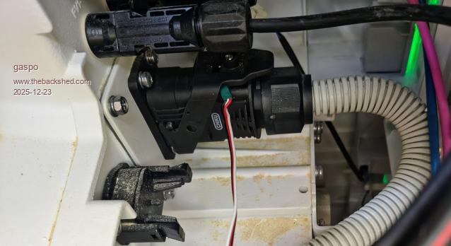

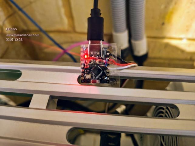

  wiseguy said  I haven't had the top cover off mine yet - probably the first thing I've ever owned and not done that. I assume that was required to get access to the connector in question? I was not aware modbus was an available option over the ethernet, you made good use of it. Does the ESP32 retransmit the inverter information via WiFi with the combined inverter plus your temperature value?
There is no need to remove the plastic cover. The back of the inverter, where all the connectors are located, is already open and can be accessed by hand from the rear.
The temperature module I built is independent of the Sigenergy data. It uses an ESP32-C3 running MicroPython code and publishes temperature data via MQTT (over WiFi) to Home Assistant. In Home Assistant, I defined a new sensor that subscribes to the MQTT topic published by the temperature module, and this sensor is displayed on one of the dashboard cards.

  wiseguy said  This morning I took a look at the inverter data page and noticed some weird information. Maybe Gaspo (anyone?) can tell me what it is up to, here is the page;
I don't fully understand how various AC powers work in the grid connected inverters. So I asked ChatGPT for inverter power analysis of my data:
Active power: 2kW
Reactive power: -1.7kVar
Phase A current 11.5A
Phase A Volts: 243
Power factor: 0.755
1. What each value means
Phase A Volts: 243 V
Normal Australian single-phase grid voltage (230 V nominal, ±10% allowed).
Phase A Current: 11.5 A
The RMS current flowing between the inverter and the grid.
Active Power (P): 2 kW
This is the real, useful power that actually does work
  - Running appliances
  - Charging batteries
  - Exporting to the grid
Formula: P=V×I×cos(φ)
This is the power your meter bills for.
Reactive Power (Q): −1.7 kVAr
Reactive power is power that oscillates back and forth between the inverter and the grid and does no net work.
It comes from:
   - Inductors (motors, transformers)
   - Capacitors (filters, inverter output stages)
Power Factor (PF): 0.755
Power factor tells you how efficiently current is being used.
Formula: PF=P/S
Where:
P = Active power (kW)
S = Apparent power (kVA)
A PF of 0.755 means:
Only ~75.5% of the current is producing real work
The rest supports reactive power
2. What does negative reactive power mean?
This is the key point.
Sign convention (very important)
For grid-connected inverters (including Sigenergy):
Reactive Power Meaning
Positive Q (+) Inverter is absorbing reactive power (inductive, lagging PF)
Negative Q (−) Inverter is supplying reactive power (capacitive, leading PF)
👉 Your inverter is exporting capacitive reactive power to the grid.
In plain English
Your inverter is acting like a capacitor
  - It is pushing reactive power into the grid
  - This helps support grid voltage (lowering it when it is above 230-240V range)
  - This is intentional behavior, not a fault.
3. Why is the inverter doing this?
Modern grid-tied inverters (including Sigenergy) are required to provide grid support:
Common reasons:
  1. Volt-VAR control enabled
     When voltage rises, inverter injects capacitive reactive power
     This counteracts inductive loads on the grid
   2. AS/NZS 4777.2 compliance
      Australian standards require inverters to:
         Adjust reactive power automatically
         Support voltage stability
   3. Local grid conditions
      Light load, lots of solar nearby
      Grid voltage drifting high → inverter responds
243 V is slightly on the high side, so exporting −1.7 kVAr makes sense.
4. Why is the power factor not close to 1?
Because:
   - You are exporting reactive power intentionally
   - Reactive current increases total current
   - PF drops even though nothing is “wrong”
This is normal and expected for grid-support mode.
5. Is this bad? Should you worry?
No.
   - Residential customers are not billed for reactive power
   - The inverter is operating correctly
   - This actually helps the grid
Unless:
   - Your inverter is hitting current limits
   - Or you see export clipping due to excessive VARs
In normal operation, this is fine.

  gaspo said  The temperature module I built is independent of the Sigenergy data....
Yes, the WiFi module is integrated into the inverter....
1. What each value means....
Modern grid-tied inverters (including Sigenergy) are required to provide grid support: Australian standards require inverters to:
        Support voltage stability....
Hey Gaspo, thanks for taking the trouble for the detailed reply with a host of useful information & clarification. The main take away for me was the requirement for installations now being required to correct for reactive power autonomously, that was a surprise for me.  And yes I missed the "-" sign of the reactive power, that should have given me a clue.
I had pictured the connector issue to be a PCB type connector not a panel/inline pluggable type - I assume that is what is hiding underneath all that shrouding?
