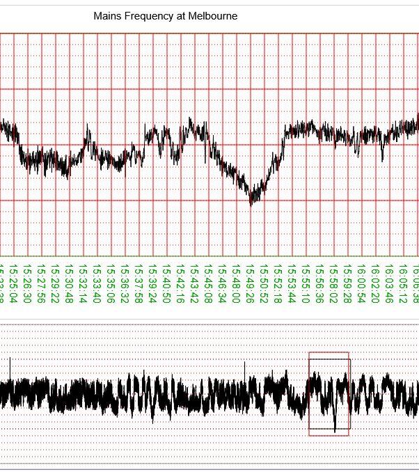

I show a phasor too, which gives an idea of how fast mains frequency phase
changes over time.Green is a fixed reference, Blue is what it was a second ago.

Today's data will be a bit wobbly due to my calibration and testing, in preparation for this
post here. there will be some spikes and other rubbish in it.

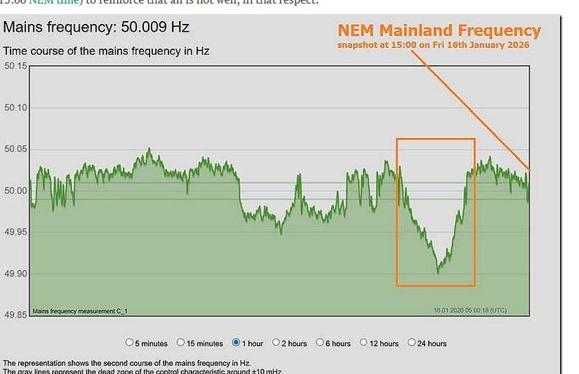

here is some "proper" mains freq data, from https://wattclarity.com.au/articles/2026/01/16jan-frequency/
and my data

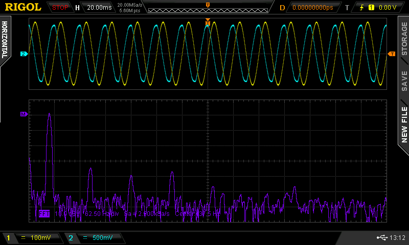

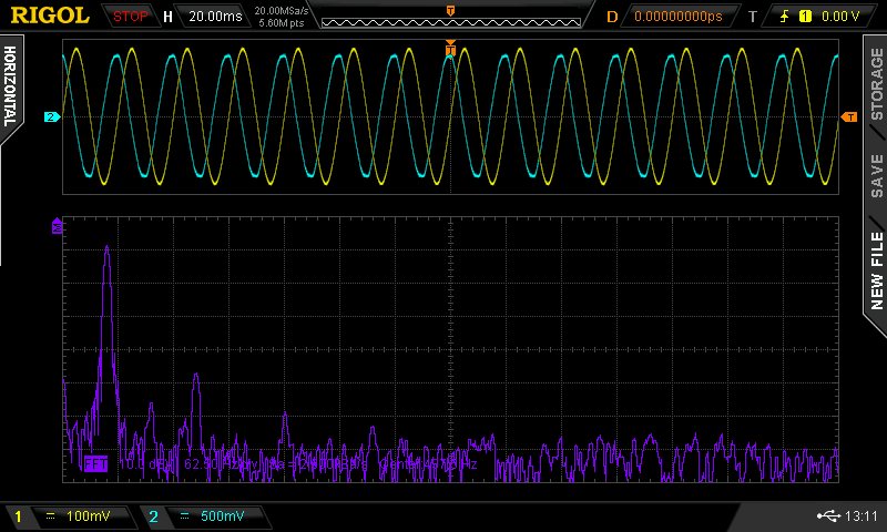

I've been playing with various means to remove noise from this thing.
now it is a lot better.
I filter the 20V AC using a Sallen-Key low pass filter with a -3db frequency of 50 Hz
Also I run the 3.3V, GND and opto-coupler output wires 2x through a couple of ferrite
rings before they get to the Arduino Due microcontroller board.
This helps with the noise from various things in my office.
before filter:
after filter:
so the 3rd and 4th harmonics of 50Hz are low less. I wanted the 100Hz harmonic to be

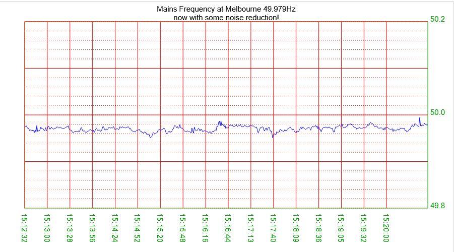

reduced too but it seems not much was done to it.
the resulting frequency graph is a lot cleaner though.
