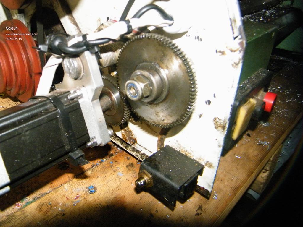

I recently fitted an electronic lead screw to my lathe. It came as a kit from China and works well.
I had to change the gearing on the stepper motor that drives the lead screw as the controller would not allow me to adjust it accurately enough.
I fitted a couple of the old gears that were in the back of the lathe to give me a 1.2 reduction from the motor to the lead screw.
Now I have it adjusted so I can cut threads on the lathe. I couldn't do that before because i was given the lathe years ago and my friend had lost the back gears, so as a lathe it was good, but thread cutting was out.
Since fitting the gears to the stepper motor and to the lead screw, i have cut some fine threads and it is working well.
But if I try to set the thread to say a 12 tpi thread, the stepper motor goes mad and doesn't seem to know what to do, it makes a terrible noise and stops itself after a short time.
I am wondering if it is picking up some stray signal that upsets it, it cuts fine threads perfectly but goes into freakout mode on coarse ones.
I don't have access to the controllers programming except to change settings for the lead screw movement, the pulses from the controller and how many pulses the unit measures from the encoder.
I am hoping that someone here can tell me what to do, the stepper motor ran fine on coarse thread settings when it had a toothed belt drive to the lead screw, on a 1:1 ratio. But now it has a step down 1.2:1 ratio it doesn't like it.

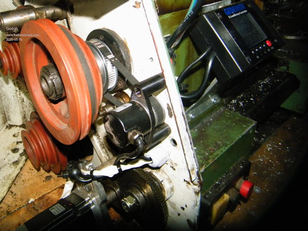

Here are some photos of the unit.
I am wondering if the stepper motor can't run fast enough to drive the lead screw at the speed required for the coarse threads.

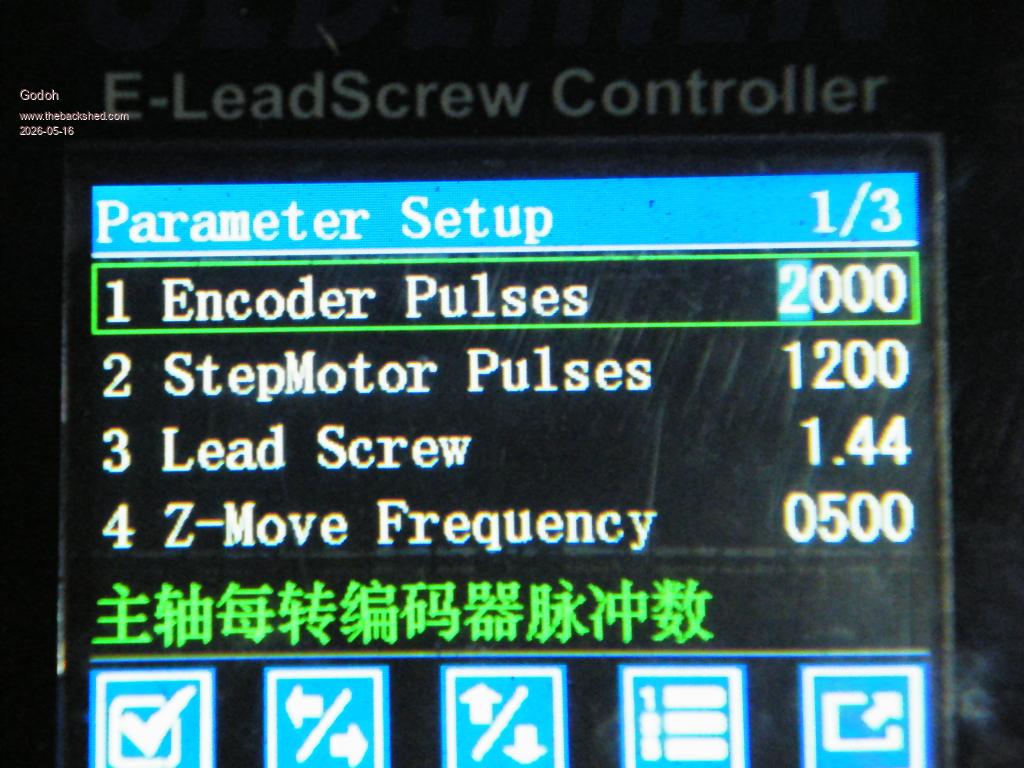

Ok this is the first lathe I've seen that uses an encoder for rotation position so I have to ask is that
1 Encoder pulse 2000 ' is that exactly a 360 degree rotation
2 Stepper pulse 1200 ' what is the leadscrew pitch and is it metric or imperial
3 Lead Screw 1.44    ' Please explain what figure this is
4 Z-Move Frequency 0500 ' would this be set for a screw cutting pitch
Now for a 12TPI thread each rotation will move the tool 83 thou or 2.117mm.
The leadscrew pitch still needs to be known as that dictates the travel on one rotation

Hello Bryan, thanks for the reply
So the encoder pulse was set that way when I got the gear. The kit came with toothed belts and pulleys and the setup was already programmed in.
I did check the rotation and yes as best as I can see the chuck is reading right for a 360 degree rotation on the degree setting.
Now I am totally new to all this stuff, so how do I measure the lead screw pitch ?
The stepper pulse on the controller was already set at the 1200 setting so I have just left it that way
I am fairly sure the lathe is metric, but there are adjustments on the controller to cut metric, imperial or custom threads. I have cut some 28 tpi threads with it and they appear to be pretty good.
The lead screw setting is the one I have changed to get the tool carriage to move the correct distance when I run the machine. I tried heaps of settings up and down until I got the one that moved the tool carriage the right distance. So the 1.44 setting for the lead screw is the one that lets me cut threads and machine automatically accurately.

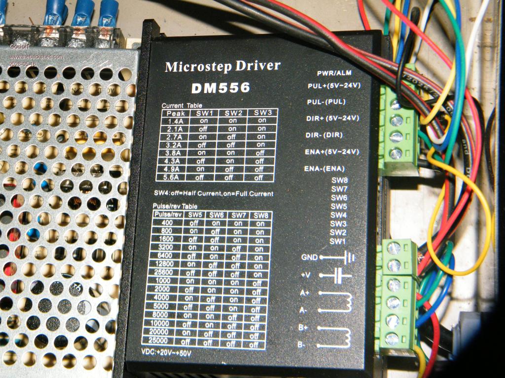

OK Pete grab your vernier or just a 6" rule and measure the amount of threads in 1" this will give you the TPI of the leadscrew and if the count doesn't come out right it's metric leadscrew so measure from one tooth to the next which will give you the metric pitch.
Mate I'm an old school heavy machinist where I used to think the bigger machine was the best as when the old guy's died out I would be still in tune but sadly the heavy machining died in this country along with the old guy's.
Now as you have a 1:2 gear ratio driving the leadscrew it's double the pulses for one rotation so what is the DM556 settings as I did find when I tested the Y axis on my surface grinder it did hammer so by raising the current on the first 3 switch's where 2.7 amps with switch 4 off did reduce the holding current from a amp to 300mA and got the stepper working nice.
You have that Ching controller that just needs the right info now with setting the DM556 up to give the stepper current needed should solve your problem.

Hi Bryan the DM 556 setting is for 2000 pulses at the moment.

Ok mate Now all you may need to is move the first 3 switch's to set the current and leave switch 4 off to reduce the holding current.

I have not read all of the above but can you tell me what current setting
you have with the stepper drive?
depending on the position of SW1, SW2 and SW3 you set the current.
if the current is too low, it won't run fast or pull high loads,
it will just whine and think it's going somewhere (sounds like some
people I have shared a car trip with)
See what is said on the motor, as far as max current is specified.
then set the switches to that or maybe 1/3 more.
I have built about 5 machines that use steppers in the past.
They feel no pain if you give them a bit more current.
The drive says it's good from 20 to 50V DC. Obviously running near
50V will give you the best chance to drive a difficult load.
what voltage is supplied to the stepper drive?
(I have a few of these here at work and they have been reliable in my
use cases)
