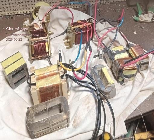

Question directed to Revlac re: Aurora chokes. I'm now regretting pulling one of my two 5 kW Aurora chokes apart after seeing one in use, untouched, in your build thread. Not to worry because I have two more 3.6 kW units OTW, there should plenty nuff components there. I can rewind the bare choke as well.
Did you ever test that choke to saturation?
Picc of my choke candidates posted again for reference. I'll proceed with the build without the DSO in the interim, having confidence in my choke parameters.

I didn't do a saturation test on the Aurora choke, didn't see the need for it as Poida and others tested and posted results of many chokes (not one of these that I am aware of) these were a little bit bigger cross section than the aerosharp cores and results should be marginally better.
I still have one Complete 5Kw Aurora choke and will check it with the LCR tester (if it still works)when I get time tonight or in a few days orso, I need to build another charge controller anyway.
Edit:
Ok found something I was looking for, The lab power supply I have is only 30v not relevant but it has a USB power supply to run the LCR meter to test the choke.
I have photo's but you will likely do your own later so here are the numbers, The choke as is tested 517uH, now with the loop at the bottom cut One coil measures 157uH then join the 2 in parallel (as in the photo take not of which winding's are the inner layer and outer layer) I get 145.9uH
You may wind your own but this is an easy start for a first build IMO.

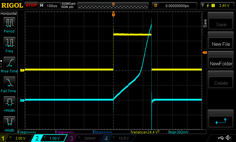

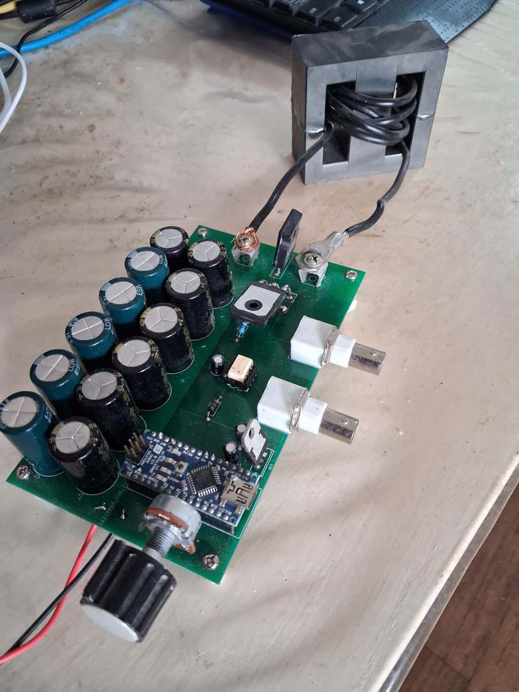

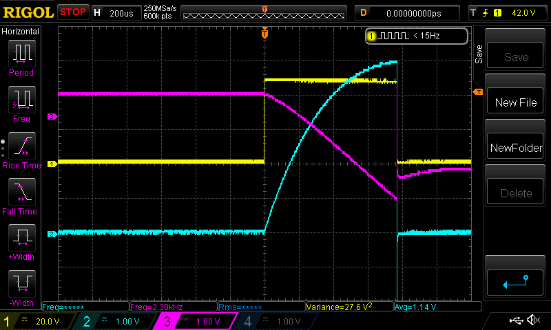

my choke tester:
A simple thing to do, that will be a good exercise for the skills
you need to build upon if you want to make your own inverter.
basic operating idea is to have a variable length pulse (5V)
come out of the microcontroller and use it to switch a MOSFET completely ON
and so put a voltage across the inductor under test.
My circuit uses a TLP250 opto coupler to obtain the required 12V drive to fully switch on
the FET. 5V is not enough.
I need 2 signals, which are displayed on the DSO.
Yellow trace is the 5V pulse from the Nano uC
Light Blue is the voltage across a 0.02 Ohm resistor that is the last thing
in the circuit that charges the inductor before Ground.
We could test the chokes (or inductors..) at far higher voltages
but things are simple and easy when I do it with a 12V supply.
eg. 2x the voltage is the same as 1/2 the pulse time.
The basic inductance equation used in testing the devices is
L = V x t/I
L is inductance, in Henrys
I is current, Amps
t is time, seconds
V is voltage, Volts
In practice, we will look for the change in current that occurs during a
period of time.
I see the pulse length is 150 uS
I also the the change in current is about 1.5V across the 0.02 Ohm current sense
resistor. This is about 1.5 / 0.02 or 75 Amps  (V = IR and of course I = V/R etc..)
Volts is 12.1 V from the bench supply.
L = 12.1 * 0.000150/75 = 24.2 uH
The BK Precision LCR meter has it at 24.6 uH
The current increases linearly and in a nice straight line too.
I like to see measured results illustrate theory so nicely as in the above graphic.

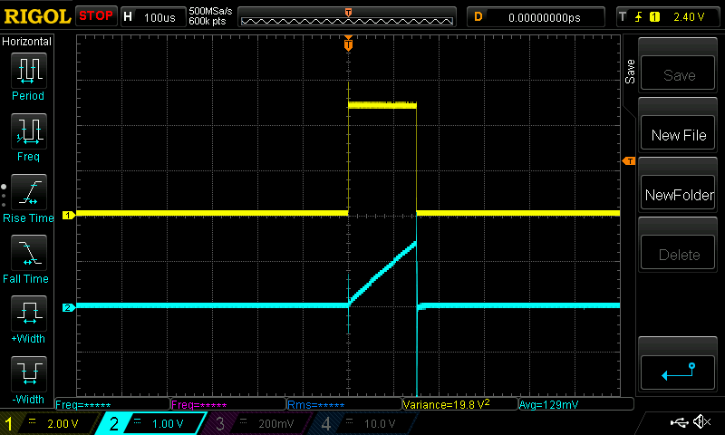

Now when I increase the pulse width a fair bit, we can see the current increase a lot faster over time after about 180 uS. This is when the choke is becoming saturated.
It still IS a choke, with some inductance. But it's value will be a lot less than when it was not saturated.
260uS, 5V over 0.02 Ohms, 12.1V supply
L = 12.1 * 0.000260 / 250 = 12.6 uH
this is the schematic I used for the PCB
Schematic_inductor-tester_2026-05-31.zip

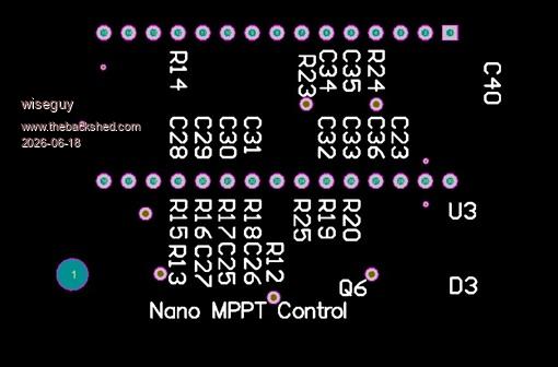

Here is a PDF print of the Assembly drawing for Rogers version of the MPPT. I hope Roger does not mind me posting this on his behalf.
Assembly drawing
MPPT-Roger.pdf
Note: In the PDF, inside U1 is the missing designators from around the Nano as there was no room nearby to place them easily
Below are the Nano SMD Designators on top of actual component positions - hope it helps
Note: C28, C29, C30, C31, C32, C33, C34, C35, C36, C37 are 1206 not 0805 - you may be aware of this.

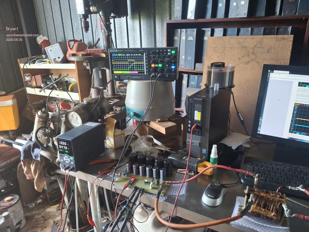

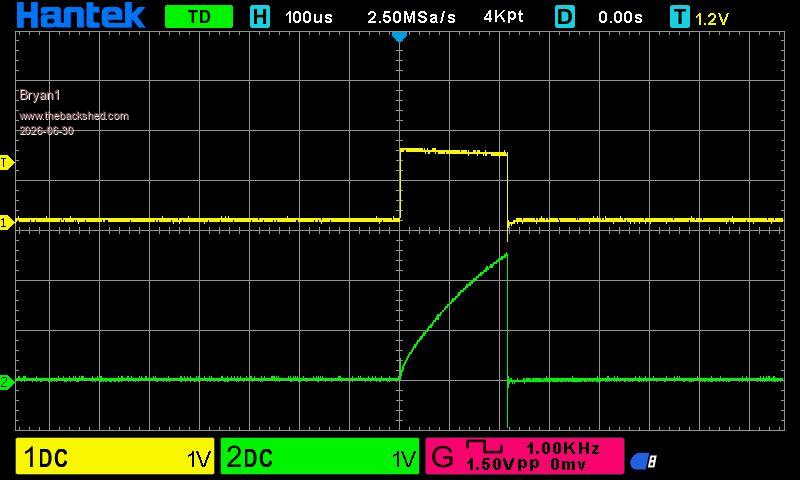

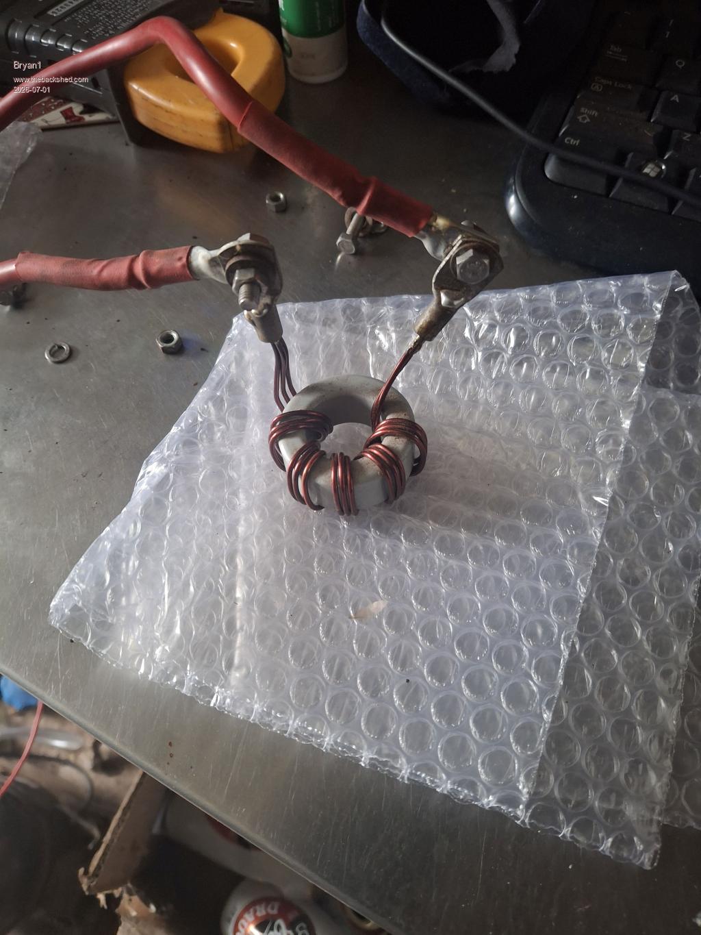

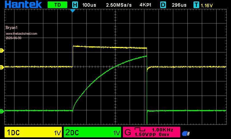

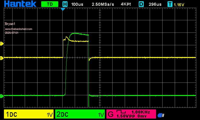

Well guy's that package finally came from element 14 so got my induction tester all finished
Here is a pic of the setup
Now this was with a 210us pulse So with a 2.5 voltage rise on the sense 2.5/0.02= 125 amps
Now a 320us pulse the voltage rise was 3.1 volts so 3.1/0.02 = 155amps
So I pretty happy the tester worked and as I didn't have any TLP250's I used a FOD3182 which just worked.
Now time to test the second choke I made ages ago...
Regards Bryan
Edited 2026-06-30 15:18 by Bryan1

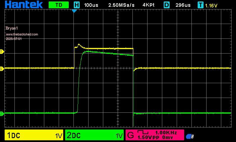

Bryan1
Joined: 22/02/2006
Posts: 2297
Posted: 05:31am 30 Jun 2026

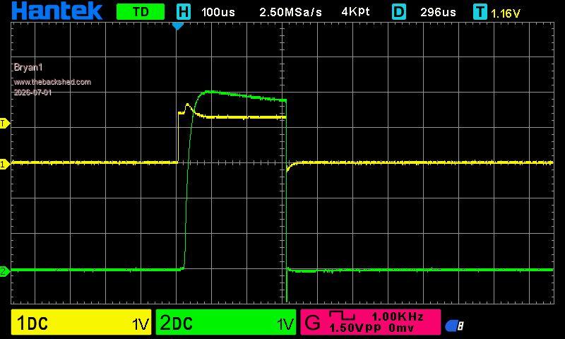

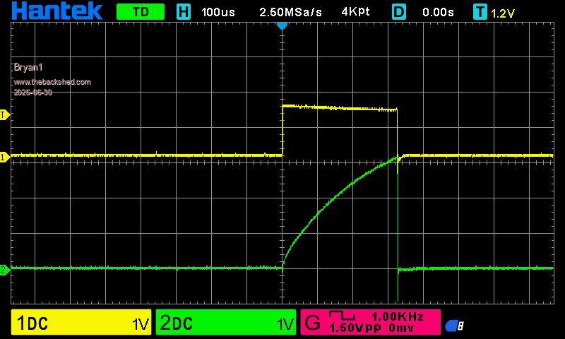

Had to go into town for some stuff and got thinking with the test on that dual choke not going into saturation mode another test was needed when I got home.
Now I widened the pulse until the sense trace started to falter and found the sweet spot where the sense pulse was stable.
505us Pulse 3.6 volts on the sense trace so 3.6/0.02 = 180 amps
So I do think Tony's old design is still up there with more modern chokes
Regards Bryan
Edit: Now just tried each side and both were the same where around 3 volts (150amps) was the sweet spot before the choke saturated so on a 24 volt system the choke should handle 3.6 Kw which is about the limit for 24 volts.
Edited 2026-06-30 15:50 by Bryan1
Posts: 3412
Posted: 06:19am 30 Jun 2026
Look at the pics in Poida's last post.
Saturation starts when the trace kicks upward more steeply, not when it rounds off.
Do you still have the primary connected? If so the total resistance of the circuit may be what is rounding off the trace, and/or the capacitors running out of charge.
In your last photo the terminals on the right side of the choke should be shorted together to test just the choke.
Bryan1
Joined: 22/02/2006
Posts: 2297
Posted: 06:33am 30 Jun 2026
Phill in the first tests the rear 2 connections were connected together so the left connection was to each side of the choke.
Now when I widen the pulse the rounded off trace just kept going higher and no vertical spikes were seen. When the pulse was further widened the trace would drop off and on so I thought that was total saturation.
I now thinking as this is a dual choke if I connected the start of the left to the rear of the right and the same with the other side would this cause a short or would it let me do a test in dual choke mode.
I am good at letting the magic smoke out so until I'm told otherwise this can remain a thought.
