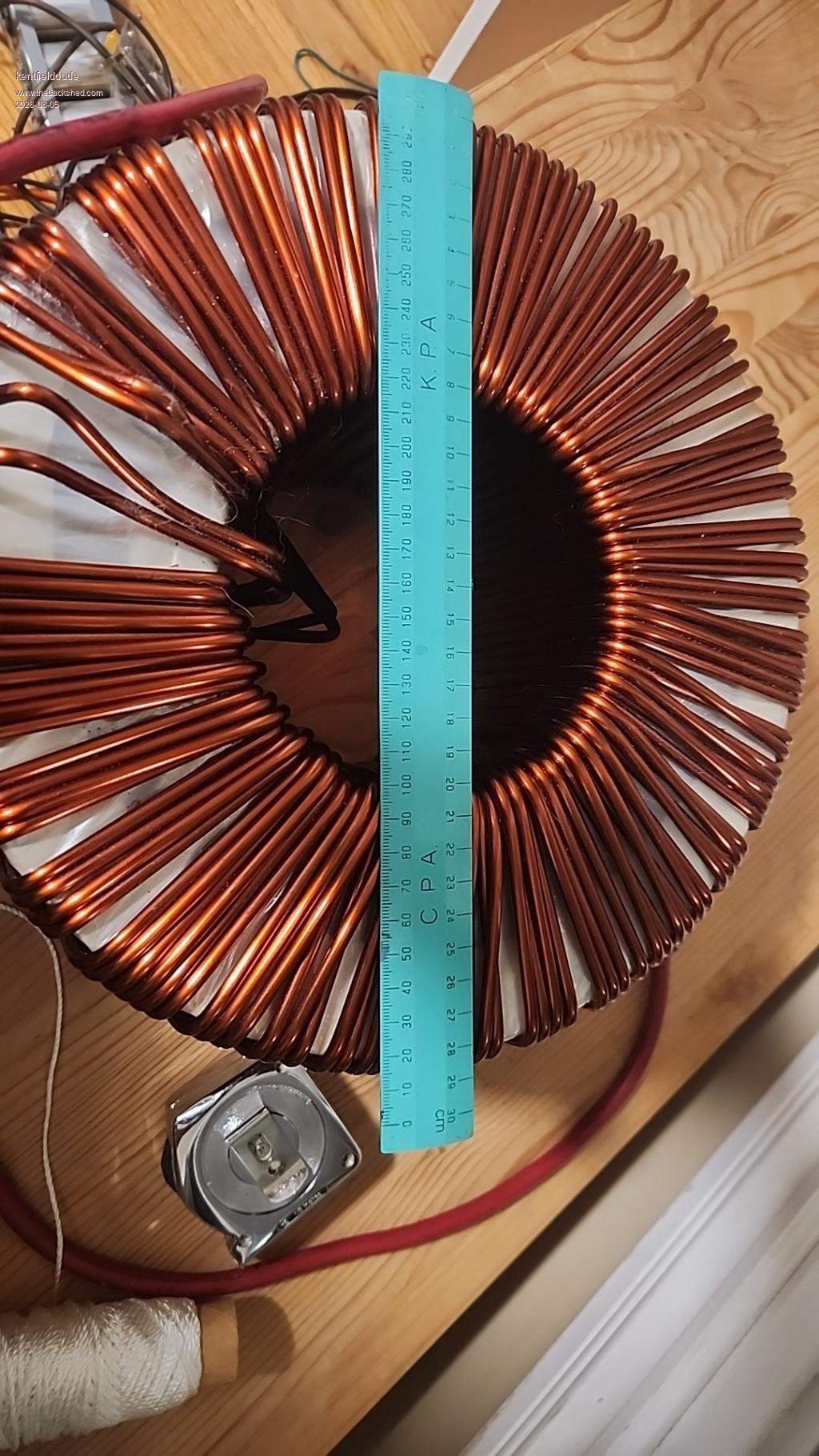

I'm trying to figure out what I need to finish the primary winding and prepare the core for the secondary.
The enameled wire got some small nicks in the enamel on the outside windings. What's the best red insulating varnish to use to repair it?
What type of mylar should I buy?
What's the best way to connect my two split windings together?

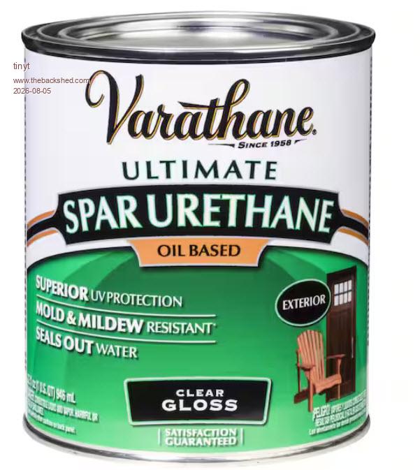

I used this. Available from our local Home Depot store.
The beginning of this thread in another forum is how I re-wound the COTS toroid. It is smaller than what you have.

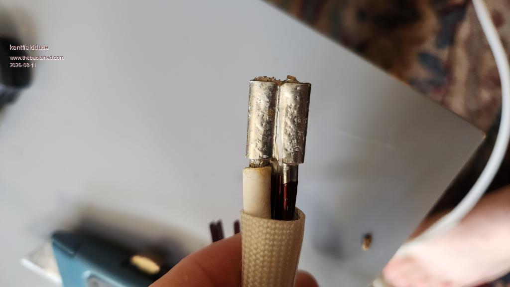

kentfielddude
Joined: 09/05/2019
Posts: 121
Posted: 02:15am 09 Aug 2026
Whats the best way to go from 16mm^2 soild copper enamel wire to a hookup wire? Compression lug?

I use crimp lugs on my connections, on my transformers the low voltage winding is fibreglass covered flat bar, so the lugs on it are crimped and soldered as well.
Solder lugs do fine too,
Years ago I bought a hydraulic crimper on ebay, it can crimp from 10mm to 320mm so does all the big connections I want to do.
Be wary of ebay lugs though, some are very thin metal and the lugs tend to break easily.
Pete

"Flag" style solder lugs can be made from copper sheet or thin copper bar.
Curl one end of the strip around the cable and drill a hole in the other end.
Drill shanks make good formers for curling it.
If you have a scrap of copper tube / water pipe it can be cut lengthwise to make some sheet.  If you are lucky it will have the right I.D for the wire already. Flatten one end for a lug or use as a joiner to flexible wire.
For connecting solid wire to flexible wire with sheet form the sheet into a tube, poke the two ends in each end of the tube and solder. Heat shrink over.
Edited 2026-08-10 13:34 by phil99

What is this type of connector called?
Pete Locke
Joined: 26/06/2013
Posts: 186
Posted: 07:50pm 11 Aug 2026
That looks to be a 'Crimp Link' connector that has been cut in half.
Used for joining mains cable together, but also very good for providing a hard connection point for stranded cable.
Available in a range of sizes from any electrical wholesaler of the usual on line suspects.
