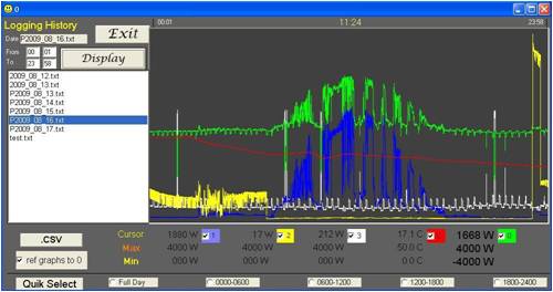

This is a plot of data I logged with a program I have written to decode the output from one of these CurrentCost meters. This shows SolarRE and house power and offpeak power and a net import/export and outside temperature.
There is a lot more that can be decoded. I have just shown real time power logging, but recording of kWhr etc is possible.
You can notice the effect of clouds on the solarRE, and the fridge and freezer operation, etc.
Gordon.
become more energy aware

Hi Gordon! You have done a fantastic job in writing this
Visual Basic software. The software that is available on
the web from the manufacturer's site is very poor. Most
impressive with your software is that you are able to
display the data graphically from 3 separate clamp
sensors. The original software simply adds the 3 clamps
values into one recorded value.
I guess the next step will be to combine the data from
one of these CurrentCost meters with the data from your
Picaxe chip. This would then provide a very sophisticated
data collection tool at a very reasonable price. Allowing
an instantaneous correlation of wind speed, and power
generated, will then allow far better analysis of a wind
turbine's performance!!!
Great work Gordon!!!!!!!!
It must be pleasing to know that you have produced far
better software than that from an IBM software engineer.
