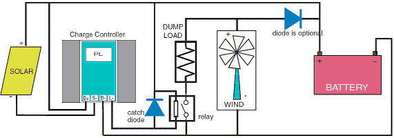

Hello Again,
I was wondering if someone knew anything about the Xantrex C40 Charge Controller - specifically whether solar and wind devices could be attached at the same time - and what mode to run it in.

Not sure about that specific controller, I use the Plasmatronics PL20 myself, and asked them the same question you did.
I guess most of the controller are fairly similar, so their reply may be relevant.
In short, the PV goes through a series type regulator, so it can limit the current, and control the voltage across your batteries.
The Wind turbine goes straight to the batteries, and the "shunt" part of the regulator operates independantly. If the battery voltage gets too high (as would happen if the batteries are fully charged and you still have power comming in from the windgen) the regulator simply switches on some shunt load. (depending on the controller, it will either PWM this, or just operate a relay to turn on or off a suitable dump load).
Crude, but probably effective.

There are a tonne of charge regulators/controllers out there - most referred to as Solar/PV Charge Controllers. I was looking at the Xantrex model because they specically state they can be used for solar/wind/hydro.
I see the suppliers of the Plasmatronic PL range provide detailed instructions for a solar/wind/hydro setup with their units. The following is an image extract from one of their technical docs.
PL Regulators and Wind - Sheet 1
How to use PL regulators for solar in hybrid wind and solar systems.
PL Regulators and Wind - Sheet 2
For use when the max current on the wind generator is higher than the max load current on the PL regulator.
Can anyone advise of other Solar/PV Charge Controllers that I might be able to use this way?

Hi Ryan,
Yes I have one of the Oatley regs. The problem I have is that the life of the AGM batteries is greatly reduced if charge voltages over 14.1v are used. The Oatley dumps raw voltage into the batteries - which is OK for wets and SLA's because they're self regulating.
I'd have to regulate the voltage before it hit the batteries - unfortunely I'm not savy enough to do that.
