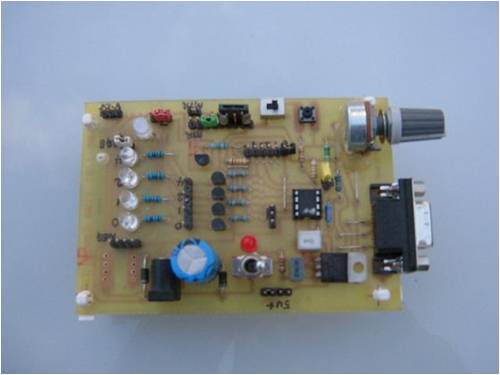

Hi All.
I see there has been a little interest in building data loggers and also noticed that electronics is somewhat outside of the depths of abilities of many.
What I am considering is a on line forum project about building a data logger so a beginner in electronics can construct one of these things in stage by stage steps.
The idea is to help others understand some basics in electronics and some programming of picaxe’s etc.
We all start some where and need a little help to begin with.
This is not a project I wish to do alone and would like to know if I can generate the interest of other members to help get this up and running.
Gordon, Trev, Vasi, Oztules, and anyone else, can I count on you guys to pitch in on this.
I am prepared to do the artwork for the pcb and even make a small batch of pcb’s for a small fee to cover board and postage cost if need be. I would rather people make their own if able but not everyone can do this.
I would like to do a two part project with the intension of the logger being wireless.
The first half being the base of the logger with the ability to take a 433.92 Mhz transmitter module.
The second part being the receiver for the 433.92 Mhz module.
Both modelled around the 08M picaxe for simplicity and cost.
The wireless part would be optional but the board would be capable of either way.
The board would be designed for through hole components (sorry Gordon) for ease of ability of the lesser skilled constructors.
Who is prepared to put their hand up to assist in this.
Secondly and more importantly who is interested in being involved in such a project to build a data logger and learn something about electronic construction from scratch.
I would aim for a budget of lets say $50.00 for a ball park figure but have not costed things out and would depend on where you accessed the parts from.
The over design would be based around Gizmos data logger and Gordons refinements if I am able to access them.
With a view to keep things simple but practical.
I look forward to any input anyone can offer.

Hi Guys,
Gordon,
Yes we are a rear breed that is becoming extinct fast and would like to try to give some that are willing to give it a go, a chance to dabble into the black magic of electronics as we have.
The basic circuit I was thinking of was not to be the best we can do by far, but a basic project to introduce others to electronics. (small component count)
The KISS theory – keep it simple s?
Some may be even challenged at soldering. We tend to take our own abilities for granted.
The question is can I count on you to help get this up and running??
Gizmo,
I had checked out Gill’s circuit and considered doing something on similar lines but as I said above KISS was the aim.
I am still interested in doing a version of Gill’s circuit but using a 18X picaxe instead as it has i2c and 2 pins can then run the display and anything else you care to hang off the i2c buss line including a keypad, Eeprom, At-keyboard, RTC, led displays, etc. as each has its own address and answers to the master when called upon, in the mean time just go about what they were last told to do.
This sort of system is simple and has low component count but requires more programming skills.
Lets say level 2 in electronic projects.

Tinker,
If you just want to have a play with wireless TX & RX I have a few sets of boards made here for a different project. ( the ones pictured in the making pcb article)
They will transmit battery voltage, program codes, board settings etc. and have a spare pin on board that could be used for current with the addition of a resistor, zener diode network added in a off board mount, used in conjunction with a shunt resistor.
You will need to supply your own 433.92 Mhz TX & RX modules (they just plug into sockets provided) and 2 x 08M picaxe’s other wise the boards are complete.
Recording the data to a pc is beyond me and not my in field. ( I know my limitations but others could help you here )
I can bring the data up on screen in Picaxe programmer using the Terminal window, but not record it.
It is fun to take the data and belt it through the air, pick it up the other end and display it on the pc screen.
It would give you a reasonable insight into how to construct and program using wireless systems. Very basic really.
If this is somewhat of interest to you send me an email.

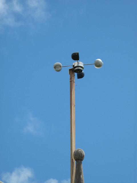

You mentioned you would like to record wind speed.
Do you have any way of generating this data to start with. As this is another project to build.
I am at present working on building an anemometer which uses a 08M picaxe and it would be a good project to start with to get a basic feel for programming and the picaxe and can be incorporated with the data logger when built.
I built one using the head assembly from an old video and this gives 6 pulses of data per rev via hall sensor, but feel it is not enough data per rev and have changed the design to use the guts from an old hard drive.
Would you be interested in building an anemometer?
You would need to find an old HDD. (standard 3.5" drive )
