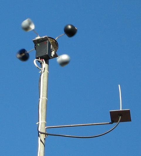

I have been building an anemometer with wireless data from a 433.92 Mhz TX & RX modules.
The signal reception was poor to say the least, with gray spots in reception every where inside and intermittent data streams of corrupt data.
Several antenna styles tried from bought rubber ducky style, to straight wire at 1/4,1/2,full wave and little improvement.

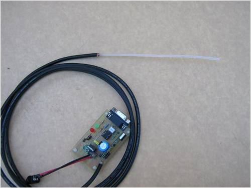

In desperation i decided to try mounting the antenna away from the circuit. This required some coax cable and in stripping the outer back, i got an idea to use the inner conductor with the outer shield removed for the antenna.
The outer removed and the exposed inner trimmed off at 172mm (1/4 wave ) above where the outer shield stopped.
In the first attempt, i passed the inner through a hole drilled in a piece of copper clad circuit board and soldered the outer to the copper clad.
The inner conductor was connected to the antenna pin on the circuit board and the outer shield connected to the negative on the pcb.
This gave a huge difference in reception with constant valid data.
I only had 75 ohm coax for the first one, but think 50 ohm would be better.
Today i picked up 2+m of 50 ohm and with 172 mm of inner exposed and no ground plate, the coax connected to the receiver end (same connections as with the TX end) i had a even better reception.
I feel it is worth while to do for anyone using 433.92 mhz modules for data transmittion.
It allows for the antenna to be moved and mounted for better reception if needed.
Any input on improvement from anyone with antenna knowledge would be helpful.
Only other tips are use a coax that has some copper conductors in the outer shield so it can be soldered to the pcb, and the inner conductor should be a solid core and not multi strand as in some 50 ohm coax.
A blob of silicone on the end and around where the outer sheath finishes to keep water out.

Search for <coaxial sleeve antenna>. I believe you need the other half of the dipole which is decoupled from the feedline for best performance. 1/2 wavelength would be the best but you need a balun to get it "closer to theory".
Not sure what you mean by full wavelength. Matching to it would not be straight forward.
The ground plane for a 1/4 wavelength antenna should also be a 1/4 wavelength or bigger and usually tilt down from the feedpoint at about 45 degrees. See <ground plane vertical antenna>
Do you want omni-directional or could you use a small Yagi antenna?

I put together a 1/4 wave vertical ground plane antenna.
Thus far have only had it on the receiver end and have good results from it.
I intend to mounting it on the transmitter end but in reading i see that poles and the likes give interference.
The thought to mount it directly above the anemometer came to mind but not sure on what effect the spinning, whirling, gizmo beneath the antenna will cause.
Any thoughts on this?
The intended mounting would place it around 200-300mm above the anemometer.
Or would i be better to mount it off to one side as the present antenna is in the photo above.
Pete.
