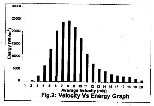

Hi Daniel,
from your data, you have a very windy site. Probably even give oztules site a run for the money.
For your loading requirement, and the enormous amount of energy available, you could probably get away with about a 1m^2 rotor area for a HAWT. You could probably get a VAWT to provide enough power.
A low speed HAWT would need a heavily stalled rotor, with a mid sized rotor dia. You do get significant winds at 20m/s. Good windmill protection systems will need to be in place.
Will need a little more info re wind energy distribution through the year to help any more.

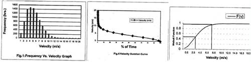

I have appended the other graphs I have available for the given location. This is not the only location I'm interested in establishing a windmill though, but I haven't been able to get the data for the other location yet. But I know it is farther inland so it will naturally contain less energy, as this you're looking at is from a larger island (St.Martins, Bangladesh) close by.
I would prefer to build a Hawt with a three or five blade design with a very simple airfoil made from large diameter Mosa bamboo. This is not much different than the popular "PVC blade" design. Resin infused blades with a core of bamboo is also possible, but not plausible as I want it simple and extremely cheap to change and manufacture oneself, on site.
However, I feel stuck right now because I can't make any approximations of airfoil or size of turbine since I do not have any data from the generator its supposed to drive. I need a power and torque model and to get those I need to figure out a way to, preferably non-intrusive but accurately, obtain these.
The power regulation is supposed to be by automatic mechanical furling. This seemed the simplest way of reducing swept area.

Hi Daniel,
is it possible to post the middle graph by itself?

Ah, yes. I see it became a bit too small.2010-03-11_080429_vind.zip

Posted: 11:03am 11 Mar 2010
looking at them more carefully, you wont be giving 'tules a run for his money any time soon, looks more similar to my site but I have more than 2000hrs of 5m/s
A great site meets the 80/20 rule and that is 20% of the time you'll be making peak rated power.
Unfortunately, the only one we know of is OZtules who just goes outside and turns on the mill when he wants some free power any time he likes, charges up the car, few batteries etc.
I used to think my site was pretty good and it sure is better than most but 80/20 is not looking promising.
more like 87/13 which looses me 500KW/HR a year over the 80/20.
