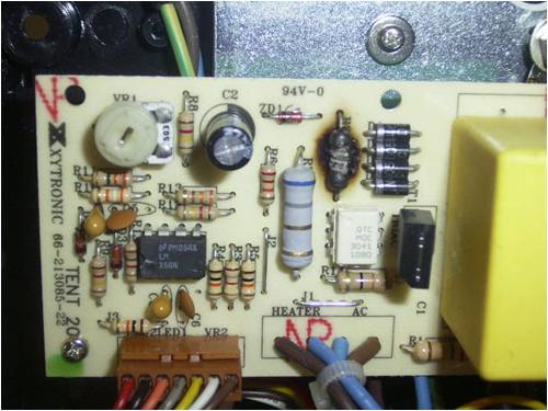

I was using my soldering station the other day and a strange noise came out followed by smoke. It was my fault as I was using it with a small 150 watt invertor I have that plugs in to the lighter socket in the ute. (mod sine wave I think) Worked well untill the reg came in and it started to buzz and then smoke.
I would like to know if anyone has one as I need to know the risistor value as it is now black..

I cant help with an exact value, but would suggest you measure the burnt resistor as it may still be somewhere near its value as the paint is burned but it is intact. However I think there is a fault in the circuit that made it burn, as it looks to be a power circuit resistor. indicating that it had way to much power running through it so there could be a short somewhere else in the heater circuit. Measure the circuit resistance at the board and then unplug the solder iron and check again, also measure resistance to earth the same.
Also check the circuit board for track jump as a square wave inverter is inclined to cause arcing between tracks if very close.

Replacing that resistor is only half the problem, you'll need to find out whats shorted out elsewhere in the circuit. That resistor would not have failed on its own, its a sympton of another problem.
It looks like there is a opto-coupler driving a triac, which in turn is turning the iron heater on and off. Chances are those components are OK. Check the diodes and that zenner for a short. I cant quit see what the IC is, a LM354?

I suspect the square wave inverter killed the triac.

I have put the meter on it and It is weird.( It's on Ohm and and auto range) One way I test it, Eg red to the out side pin black too inner it reads 1.245meg ohm but it climbs to 1.9 meg. When I test it with the black on the outer leg it reads 29.5 meg ohm and it to will not settle and climbs to 34-35 meg omh.
The IC is LM 358N.
Yes the opto does run the Triac.
The PCB board has marked on it it was made by:
XYTRONICS 66-213085-22

Resistor value is 220 ohm / 0.5W and it is a zener resistor for 358 input, so probably apparatus will work again, after R2 replaced. :) . So did mine.
