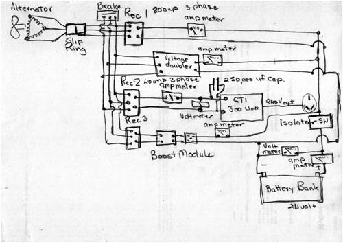

This is a mud map of my experimental setup on my mill, also have a 300 watt and a 600 watt GTI on the dump load on the battery pack using Glenn's dump load circuit. I have mine set to cut in at 27 volts and drop out at 25 volts, they will go to 30 volts but cut out on over voltage. Mine will draw 12 amps at 27 volts and a bit higher until it heats up. It just starts to conduct at 15 volts around 2.5 amps from memory. I have tried it on the solar but the volts go to high and it cuts out (24 volt system) voltage 40 on a good day need MPPT to the batteries, I got a 22 to 55 volt 600 watt unit but haven't tried it yet as we have had to much overcast weather.
All the best
Bob
Foolin Around

Amc-elec
VK4AYQ
Joined: 02/12/2009
Posts: 2539
Posted: 01:42am 16 Jan 2011
Hi Alasdair
You could put a switch mode current limiter in circuit to protect the windings if you think it necessary, but remember the volts are the thing going up not so much the amps
so the watts go up but the current in the windings stays at a lower level.
The GTI I have are rated at 14 to 28 volts so using them at 27 volts is within their rating and I found that they cut out at just over 30 volts, I have some rated at 22 to 55 volts but not much good unless I put them direct on the solar panels, as they go to 40 volts OC and loaded 34 volts where it works well but not to full output, it needs to get to 48 volts to do that. I think the MPPT system in them is a basic voltage Dependant current limiting device as they go to a certain amps then plateau at that but as the volts go up naturally so does the wattage.
With the fragility of the generator it would be better to make a active furling system for high wind events as a dc generator could cook up if allowed to run wild in the wind. Dump loads only are a success to dump excess power when the generator is charging in it's normal range and the batteries are full, to short one out in high wind would be a disaster.
If you are worried about the windings it would be a good idea to do a low voltage motor on the generator for a few hours to heat it and dry out the windings, then vacuum bag impregnate them with epoxy resin, it is a bit of a pain in the bum to do but will keep it alive for a long time. It would be a good idea to do the fields as well if you can get them out. They aren't as critical as the armature as they can be rewound easily.
Have fun with all the fiddling.

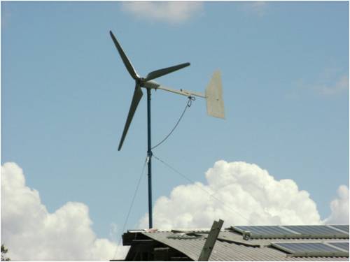

Sounds a bit complicated for an old bugger like me, I have a old Chinese mill with no slip rings and use a bungee cord toed to the tail, it can rotate 2 turns then the bungee cord winds up and brings it back to normal.
Note the bungee tied with precision and finesse onto the carefully fabricated tail extension.
I use high quality bungee from a sail maker as it is purported to be UV proof, a bit crude but it works like a treat.
With your system you may find it has torsional resonance in the inner tube to cause a resonance and make noise or worse destroy the head.

of a dent anyway. What do you think of offset furling
with a sprung tailboom to allow the blade to blow out
of the wind while the tail remains straight.. ish?
Regards Alasdair.

I have mixed feelings about furling, and in the past have left the mills run, as a bad furling device can and sometimes causes more damage. With my new mill I have been forced to revisit the furling issue as the structure of the mill is such that it cannot stand high speed operation from an electrical and a structural point of view.
The original design of the furling didn't work as once the tail was extended to the point of reliable wind tracking it was to heavy to furl properly with the existing design angles. On Phills advice I have modified these angles and fitted a larger and lighter tail vane. The recent storms have been very severe with gusts fast enough to rip trees apart and blow things around the property.
Due to the heavy rain it was like watching the mill through a milkshake so I couldn't draw any Hi Tech conclusions from the event, suffice to say that I could see the blades slowing on heavy gusts and re accelerating as the gust dropped back and all stayed together, some of these gusts where measured in excess of 25 ms before the lightning took out the weather station radio link, and it got worse from there, the fact that it did survive the event proves that it worked, whether it was at the proposed 15 ms maximum, where the generator is at full output or not is still open for proof.
The angle setting I used was 5 degrees lay back and 10 degrees to the side with 4 inches offset on the mast head for a 2.8 meter blade This is a starting point for the next mill, but will have 5 inches offset due to larger blades 3.65 meter. I also reduced the weight of the blades to reduce gyroscopic loads
After doing a lot of hands on static testing I believe these angles to be a good starting point for furling, and the offset to suit the blades bigger or heavier blades more offset, with a tail boom length of .7 the diameter of the blades.
I have read many different angles for mills to furl from different authors and I believe that each one has merit for the blade alternator setup the author was testing, but the variability of our blades and alternators / generators doom us to confusion unless the exact same machine is created.
http://www.thebackshed.com/Windmill/Docs/Furling.asp
I plan to put a sliding weight on the tail boom to tune the response rather than a spring, due to the fact that Murphy breaks springs at inconvenient times, gravity is a bit more reliable.
The other approach is to use a linier actuator to fully furl above 15 ms with a time constant built in to hold the mill furled until it is safe to resume normal operation. This is a a deviation from my KISS methods as I don't have much faith in electronics reliability in a less than ideal environment or any harsh environment for that matter. The old toggle furl on the water pump windmills is good if you can sit and watch, but Murphy's law of observation takes precedent there.

Bob, your information is very useful, and I'll take it into account. I only
have a two blade aluminium propeller, which by it's very nature doesn't
appreciate sudden changes of direction, as the gyroscopic effects put compounding
loads on the blade roots, as I'm sure you know. Your idea of a weight is one way
I could help overcome this, a giant tail would resist sudden movements on
one hand, but force sudden movements in strong gusts. I even thought of fitting
a car starter ring gear to the head, connected to a pinion gear with a flywheel
of some sort, it would dampen sudden changes, but offer little resistance
to eventual direction. Another trick I thought of trying was to use a gas lift
strut in place of a spring, I have a couple in my junk box and they have the
bonus of damping sudden movement, and retracting slowly.
Regards, Alasdair.

Bob, have you thought about trying a tapered
coupling to hold centre? The generator/alternator
can sit on a shaft sliced at an angle with a centre
locating pin, the weight pulls it to centre, as any
deflection must lift the gen vertically, the amount of
lift is determined by sleeve cut angle and diameter.
You'd need to weld a lug at 90 deg to limit deflection.
Pack it with grease and slip an inner tube over it. That
chinese magic smoke you speak of does escape easily
but Japanese magic smoke is full of mystery, and very
expensive. I once fitted a $95000.00 Sony projector into
WMC and got to witness a magic smoke show which
included a fireworks display and a small scale
thunderclap. I distincly remember the stunned silence
as all looked on .. mesmerised. The GM then asked that most
enlightened question.. Is that normal? YEP!

A steering damper of a motorbike works well and is adjustable, $30 on fleabay.
That is a bit like cam activated furling, unless you have a groove to control the action the gyroscopic forces could make for different results than wanted.
Andrew
