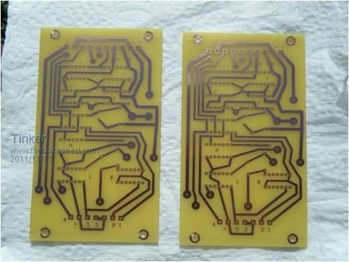

Success at last, today I etched two PCP's ant they turned out better than expected for a first time trial .
The freshly etched tracks are shiny copper but difficult to photograph all shiny.
It was a longish learning curve to get to this stage.
I had some PnP paper on hand so I tried that first before trying other media. The laser printed image of my artwork looked well so I went on to the iron on tone transfer to the PCB stage.
Dismal failure
Despite trying several heat settings and 'ironing' times the image would never fully transfer.
Then I remember reading about the 'ultrakeet' instructions how to modify a laminator for this job. The original instructions were for a specific laminator but it only did 1/32" max thickness boards - mine is 1/16" single sided.
But now ultrakeet mentions a new home laminator and its the cat's meow for this job
1. Its cheap, <A$20.- at office works
2. it has a spring loaded roller to cope with the thicker board
3. its easy to modify - see instructions on the ultrakeet website - to set it for the higher toner transfer temperature required.
4. only one <A$10 part required to modify the unit (a 160 degC thermostat)
Of course, once modified its only good for PCB's
I think it takes all the stuffing about out of the iron tone transfer method.
The laminator is a "Lowell A4 Home Laminator model LOOL 280. Only this model has the spring loaded roller suitable for thicker boards I believe.

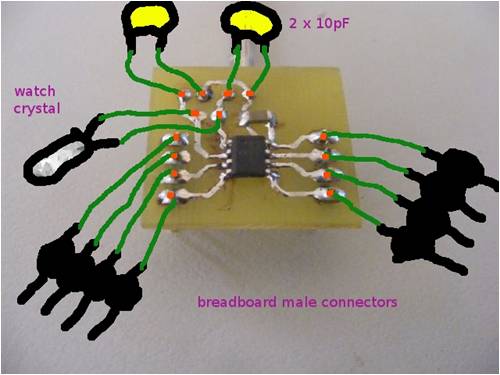

Last week I decided to give a SMD board the iron on treatment and it turned out purfect. The board is a breakout board for a MCP79410 SMD RTC chip, onboard is the watch crystal and 2 off 10pf caps also a 1206 0.1uf decoupling cap.
This is the finished board
All tested on my breadboard and working nicely. So as you can see a bare bones iron can get good results. What I do is put the board on a hardback book and just iron away for about 4-5 minutes then soak the board in warm water. As the top pic shows one doesn't need to get all the paper off the toner before etching and on purpose I used the one with most paper on etch.
