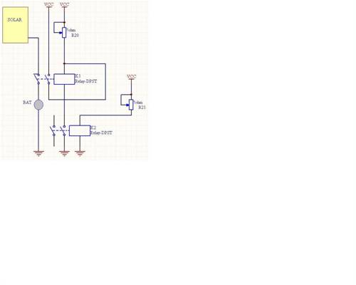

Hi. I am rather new to this so please excuse my ignorance.
O.K I have a wind gen along with a solar panel and small pico hydro. I charge 4 x 12v batteries two in series to give me 24v this I put thru a 24v to 240 v inverter, the type with built in charger. I use this power to run my house water pump, only problem is when the voltage drops to 23 the inverter shuts down and sounds an alarm
I need a switching device to cut in the units charger at say 23v and shut it off again at say 29v? as it is it is a pain having to run down to manually switch the charger dripping wet when the shower cuts out :-) any help appreciated.

Perhaps this would suit you. Choose R20 such that the battery is opened at 29V.
Choose R21 such that K1 is unlatched at 23V.
You may wish to modify the circuit such that when the Battery is open, the windmill feeds a dump load. Also consider placing diodes across the coils.

Sorry didnt read your message entirely. Use K2 to switch in the charger at 23V.

Thanks Darcy. but I am unable to view the small drawing,[did try zooming in paint but blurred]
could you please resend in larger format. thanks and regards Brian

Hey thanks for the advice. I have made up the controller as per the drawing, and set the lot up to switch the mains power on to the charger [yes the charger section of the inverter draws power from the grid] only problem I have now is how do I modify the setup to switch the charger on at around 23v and off at 30v? I had thought I would only have to set the trimpots opposite to the instructions, e.g low pot set to 30v and high pot to 23v does this make sense? apologies for ignorance.

G'Day Bryan. I guess I should have explained better. I bought the wind setup with its own controller that has its own dump, wired into this is a 200w solar panel. the pico hydro is all an experiment using a F&P motor, that is putting out around 60 to 70v though not very efficient.
OK so the inverter is one of those chinese ones with a built in charger, presently when the batteries [4 x 12 v in series pairs = 24v] get down to around 22v the inverter shuts down and sounds an alarm. thats ok except when I am in the shower and the water goes off :-(
I have been chasing around for an auto switch device that can sense the voltage drop and switch in the inbuilt charger before the inverter shuts down then switch off the charger at say around 28v. then when the sun does shine or/and the wind blows or/and the creek is making some power at least this power will still get to the bank?
I am not an electrical whizz though can follow a diagram and solder ok. So I made up the controller as recommended which is a dump controller designed to switch a relay in to dump excess power. I just need to change it around to switch IN the relay at the lower volts and OFF at the higher end.

Quote "I just need to change it around to switch IN the relay at the lower volts and OFF at the higher end."
The simplest way to solve your issue is to change the wiring on the relay. Change the Normally open contact to the normall closed and the normally open contact to the normally closed.
This way when the relay is de energised your charger will charge the battery. When your battery reaches the desired voltage your charger will be turned off.
Wouldnt you want to switch out the charger at say 24V so as to allow the Windmill and Solar to contribute to the batterys charge?
