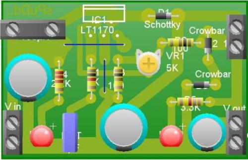

Yasi,
I built a DC-DC for same reason. I used a monolithic IC - much simpler design.
See below for files.
My DC-DC Project
LT1070 Series PDF
LT1170 Series PDF
LT1170 Series Design Notes PDF
LT1070 Series Inductor Selection PDF
It should work ...in theory

What program you used to render such image?
I ask because I like it, I see it appropriate in illustrating documentations and tutorials.

Vasi,
I used PCB Wizard 3.50 Pro Unlimited, be warned it has some
incorrect parts errors, and other bugs/issues. Yes it was a nice
pretty program, but at a price...
There's a good chance you can get free samples of the LT1170
from Linear Technology. There is also the LT1268 which is a
150Khz 7.5A version of the same thing.
