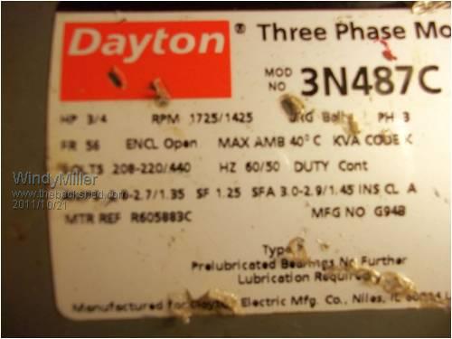

Posted: 11:11pm 20 Oct 2011

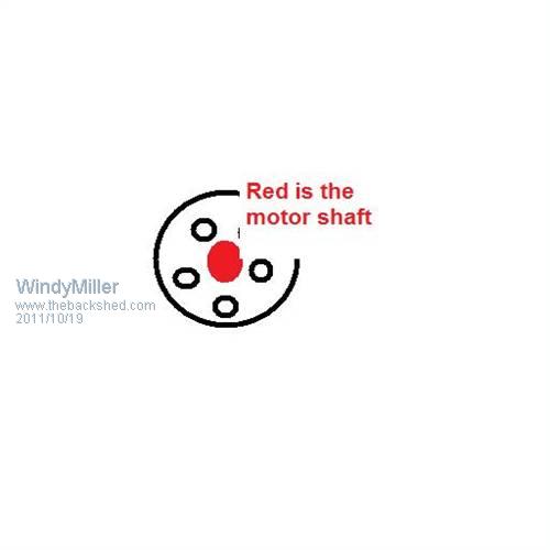

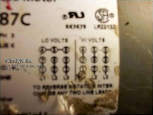

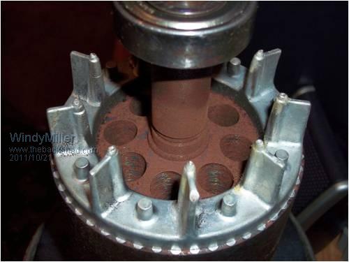

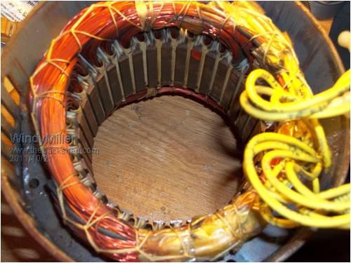

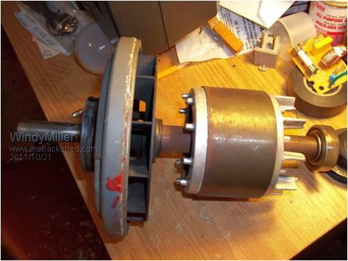

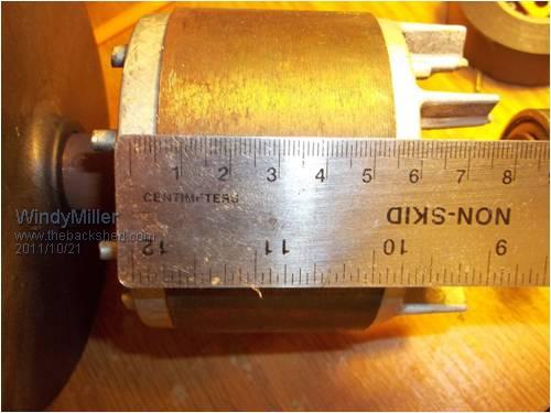

GidDay Everyone! I have decided to post some pictures of the motor I am working with in the hopes that what I am trying to do becomes clear? The two links above are the core of what I am trying to do. This link PMIG is the one I am using the most as it shows the PMIG stator and the flux fields. I just don't see why putting round bar magnets in the holes seen in the rotor would not energize the machine enough to start it generating and then use the normal cap method for full power from the machine? Should it not cause the unit to start generating at the slower speeds?
