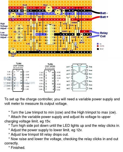

Posted: 07:16pm 13 Oct 2011
Hi, everyone! I'm a newbie here and would like to try the charge controller circuit linked above. I'm just wondering if anyone can show me calculations made for the op amps?
Thanks,
Joseph
Bub73
Joined: 10/12/2009
Posts: 116
Posted: 04:03pm 14 Oct 2011
Welcome to the forum jjbob27,
Maybe this pic will help if not do a forum search for TL084 controller should bring up lots of hits.
Bob

Posted: 10:32pm 19 Oct 2011
Thanks rori and Bub73 for the links and vero layout, However I was thinking that you can tell me what kind of operation does the op amp does? ie is it an inverting or non inverting circuit? It's for me to help doing calculations for the improvement of the circuit. I uploaded the file which shows typical applications for opamps but not quite sure which circuit is being used for this controller. In the file I found the closest circuit for the opamps with a variable resistor at the input is the Offset Voltage Adjustment for Inverting Amplifiers circuit. Please help me with this one.
