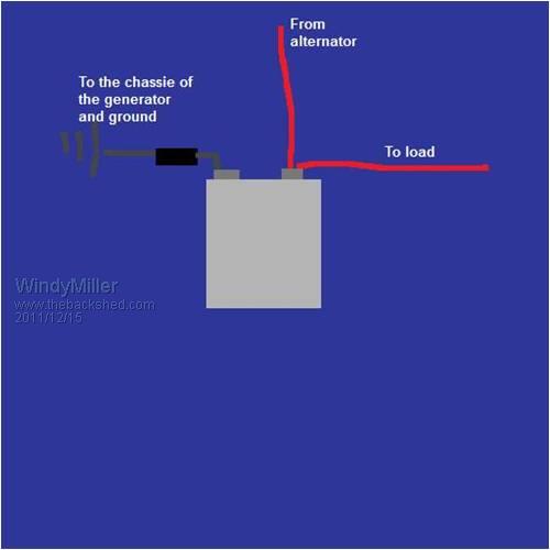

GidDay All! I have a question regarding the use of oil caps or motor run caps with automotive alternators? My question is this. Would using motor run caps in a circuit with a Delco 10 SI alternator cause the regulator to blow? Does a alternator see a bank of motor run caps as a short? What I have is this.
I have a 63 Amp delco alternator that I use for charging batteries and I have it setup so it can supply 100 volts DC for running tools, lights, etc. I have seen on websites the suggestion of using a 10 UF cap to stop from stalling the engine when alternators are used for welders. So I got to thinking and was wondering if I inserted a 10 UF cap in my generator would it cause the alternator to blow the voltage regulator? When a alternator is converted into a welder they remove the voltage regulator and such. I am interested in using the cap method with the alternator to stop from stalling my small engine when I am using this machine to either charge a really low battery or to power a 1500 watt hotplate at 100 Volts DC.
This is the projected wiring diagram. The diode is from a microwave.
Everything on my generator is common grounded to the frame.
My second question is this? If the above would indeed work? I would like to insert a 1.6 Megaohm resistor in after the diode as the resistor would not conduct at 14 volts but does for the 100 Volts DC thus completing the circuit. This method is to stop the cap and diode from draining the battery when I leave the unit sit for a week or more at a time.
For those that do not follow me please see my other post about Delco alternators. http://www.thebackshed.com/forum/forum_posts.asp?TID=4236&PN =1

Robert,
Properly designed Voltage Regulators have overload protection which limits the current (and the power dissipation) if a short circuit is applied to its output.
So I suggest that you examine the specification of your regulator.
I don't understand the second question as I can't see a diode in your drawing & I don't have the time to read through your other post.
Nor can I see why you think the resistor would not conduct at 14 Volt.
Len

Len, The regulator I am sure has a specification sheet? But I have not found any official documents from Delco? I am unable to obtain that information?
The diode in my drawing is the little black square.
The resistor I would assume does not conduct because I have one on a meter and it does not move at all until higher voltages are reached.
As I understand it you are basically saying the cap would be seen as a short in the circuit?
Robert

Robert,
Can you open the case of the regulator and look inside?
If so, you should be able to see the regulator IC (if it is an IC - it may be a discrete one)
Tell me the numbers on any ICs or transistors that you can see and I'll have a look at their data sheets.
You can't have a diode in series with the battery.
When the battery is charging, the current goes through the battery and through the "black blob" from Right to left.
But when it is discharging,the current goes from the battery, through the load and through the black blob from Left to Right. So if the blob is a diode, it will either block the charging current or the discharge current - depending upon which way it is oriented.
Also, if you have 14 Volt across a 1.6 M resistor, the current will (using Ohm's Law) will be 14/1.6 = 8.75 uA.
If the capacitor is discharged and then you apply a voltage across it, it is almost a short circuit initially. So the initial current will be very high - unless the regulator has overload protection to limit the current.
It is almost certain the the Reg has some type of overload protection.
There are broadly 3 types of protection.
1. current limiting
2. fold back
3. electronic fuse or physical fuse.
Long story,
Len
Edited by larny 2011-12-27

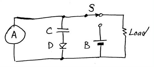

Robert,
A picture is worth a 1000 words. I drew the attachment from my understanding of your description, but it does not make any sense.
So I must have misunderstood something.
The problems with the drawing are:-
1. The alternator can be switched either to the load or with S in the other position to the battery. The battery can never supply the load. It is usual for the battery to be across the load so it supplies the energy when the alternator is not operating.
2. If the diode is as drawn, then the cap can charge, but never discharge. If the diode is oriented the other way, then it can discharge but never charge, Of course, if it can't charge, there is no energy stored so it can't discharge either.
I looked at the link. Comments:-
1. The voltage regulator is a crude design. The voltage at which it switches ON/OFF is dependent mainly upon the Zener voltage which will vary a little from one Zener to another since all components have a tolerance.
2. It would be temperature dependent so the voltage at which it switches will vary a little with temperature.
EDIT. It does not have any overload protection.
What I think you need is a well designed voltage regulator with current limiting so the capacitor can charge slowly and thus store the energy necessary to prevent the stalling of the engine when welding that you mentioned in the first post.
Len
Edited by larny 2011-12-28

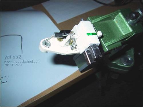

The capacitors in a small engine welder give you enough extra energy to strike an arc. For a fraction of a second it is a dead short, before the rod starts to melt, without the caps the alternator can stop dead. when the arc is lit the operator controls the resistance with the arc size, distance and angle of the rod tip from the job, which in turn effects the voltage and current the alternator delivers.In a single phase DC welder the caps smooth the choppy current so that the arc wont snuff out at a low voltage point in the rectified wave's cycle.
With battery charging the problem is a constant heavy load on a cold grumpy engine or the sudden load from nothing (to quick for the governor to catch up) stalling the motor. Capacitors will not be effective unless they are massive.
Is the delco alternator you are using a 3 wire model or one wire?
this is a three wire internal regulator.
If it is the 3 wire option, one of the spade terminals is a remote voltage sense wire. manipulating the voltage that the regulator is seeing on this wire will change the voltage applied to the rotor field coils which directly effects the alternator output.
A suitable diode or resistor on a switch on this cable will give you a choice of two charging rates and the ability to charge the batteries to a higher voltage.
Reducing the charge voltage(and therefore current)is a bit trickier.
There are two options, boost the voltage seen on the sense cable (may need an amplifier circuit for this).
Or manipulate the voltage on the regulators earth strap by inserting a diode. Both will have the same effect.
This is a mod to change the earth voltage on a bosch regulator but only suitable for very light duty, the diode is not big enough to be reliable for heavy use. You can clearly see the earth strap to the bolt hole has been cut and removed and a diode soldered in its place.
CHANGING REGULATOR EARTH VOLTAGE
On an external regulator it is easy isolate the regulator from earth and fit a switch to the ground terminal with a diode that can handle the field current and this will change the earth voltage by 0.6 volt. The diode will need to cope with the full 3-4 or 6 amps across the field coils depending on the charge rate and perhaps need an insulated heat-sink to dissipate the excess heat.
On the internally regulated delco the earth strap from the regulator is one of the three bolts that hold it in. It is very hard to do this mod without mounting the reg outside the alternator casing and running wires in to the connection points.
Ideally you should end up with 4 settings
1 no power (open circuit field wire or regulator earth)
2 low 13.6 Volt? warm up and trickle setting (diode on regulator earth)
3 standard 14.2 volt (sense wire directly to the load)
4 boost 14.8 volt (diode or resistor in remote voltage sense wire)
the low settings current output will be directly affected by the batteries resistance at that particular voltage so gels and wet leads are different.
Hope this makes sense, if not, I can post a couple of photos, as I am repairing one from a John Deere tractor soon.
yahoo
PS there are some diodes that will give a 1.2 Volt drop.
PPS not all alternators are wired this way so it is not a universal modification.
thermal runaway is a real risk for the batteries and alternator without temp sensing in the circuit.Edited by yahoo2 2011-12-30

bit embarrassing the diode on the earth strap will raise the charging voltage Sorry I had a major Brain Fade.
the only options to reduce it are, wiring the remote sense wire directly to the alternator output and placing some resistance (like under floor heating cable) in the main cable or boosting the voltage artificially.
couple of links
SmartGauge Electronics - Increasing alternator charge voltages
Self build adjustable alternator controller
I will have a look for a circuit diagram, I might not have it on this computer, it would be more than 12 years since I last modded a delco.
The professionally built engine driven chargers have two adjustable external regulators set to different voltages and a 3 way switch.
yahooEdited by yahoo2 2011-12-30
