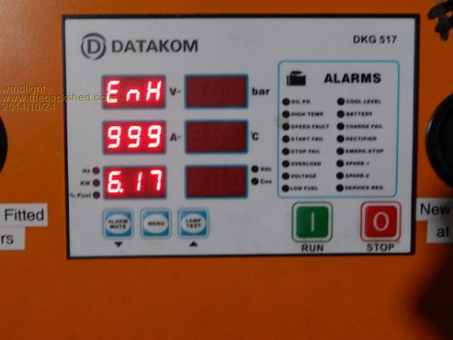

Here is a question someone may have experience with, since the Daintree has no mains power the Discovery Center runs on one of two generators. They are controlled by Datakom modules
Genset #2 has a intermittent false Hz reading when off line, I am chipping away at it one change at a time, the makers suspect a harmonic back along the neutral from the Pro. Nothing stands hard, so it is hard to say but it does appear that there is a small harmonic on the neutral. This afternoon at shutdown I plan to install a small capacitor on the module across Bat- to Neutral to hopefully snuff any stray voltage.
It has been quite dry up here so maybe the earth stake at the genshed is not making a good contact, last evening I installed a temporary bond between the neutral bar and the bat- on the module which helped with some of the resistance readings but did not solve the problem.

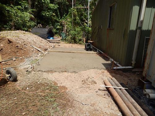

Generator shed floor

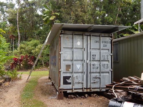

Sun roof on sea container, the container may blow away but it will be with the roof attached.

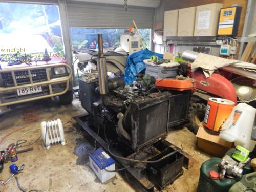

The gen set I salvaged from my play area, I had to swop over motors as the coupled one was seized (water ingress, but it goes well.)Edited by windlight 2014-10-27

Just a note, I solved the problem with the Datakom at my play pen, OK a couple of weeks ago now.
After dragging my CROW and a portable generator to the gen shed and annoying the closest neighbor in the wee small hours I concluded that it was indeed the module which was heat sensitive. I suspect his rather loud "shut up" was directed at me not his dog who was barking, but hey a kid has to do what a kid has to do.
We ordered a new one on line (love eBay) and installed it after work last Thursday (generators off line), we did not succeed in programing it then but I did on Friday. The replacement, (same model) has a different programing sequence, so much for copying from the other, good unit. Realy it was the sender unit characteristics that had me confused at first, but never one to give up.
On Friday when I sat down and studied the data, and the young fillies coming into the discovery center,the penny dropped, and a bloody big penny it was. So up to the gen shed I waddled, re-programmed the new unit and woopie it works, dropped in briefly yesterday (Saturday) and they were running successfully on generator #2, the one I was working on.
