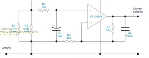

Should you want to monitor the shunt I think you would be better off with a single rail opamp like a LM358 (compared to the comparator) and might need to add some feed back to amplify the signal.
Monitoring the MPPT voltage should be easy enough using a voltage divider to set the threshold voltage from the mppt.
If you held the inverting input to a fixed voltage (say 5v) and used a 10k trimpot set up as a voltage divider going to the non-inverting input, and dial the trimpot in to give >5v out at say 32 volts at the mppt, then you would have your switch.
Again some feed back might be needed to give a little hysteresis.
If you want to use the shunt then here is a circuit you could try with a LM358 opamp.
I have not tried it myself but it would be a start, the output would need to be feed back to the second 1/2 of the opamp (dual opamp in a single package) and a voltage reference used to set the relay trip point.
The top of the circuit is missing (not needed) but the opamp was supplied by 5v i think, and the other line not marked was the V+ side of the shunt.
Note:- R1 and R2 are your shunt and not needed to be added to the circuit.
Pete.
Edited by Downwind 2012-07-30

Posted: 04:07am 01 Aug 2012
OK , I have found a workable solution. And its so simple its embarrassing to admit I had not thought of it in the first place.
But somehow my thoughts got stuck with the current metering solution at first, until I realised that in order for a charging current to flow there has to be an associated voltage....
Anyway, what I did is connect a 12V and a 15V zener diode in series with my relay coil and this lot across the solar panel terminals.
The relay coil has about 1000 Ohm resistance so it only needs a small current to operate. But this current won't flow until the panel voltage goes above 27V, at which level the batteries are also receiving charge from the MPPT output.
Panel voltage below 27V means no battery charging and the relay is off, just what I want.
