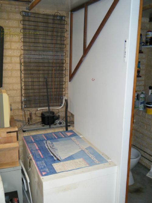

This is a description of how I made a very economical chest fridge from the parts of a junked upright domestic fridge.
THIS WORK INVOLVES WORKING WITH MAINS VOLTAGE EQUIPMENT SO PLEASE GET SOMEBODY QUALIFIED TO DO THAT IF YOU WISH TO BUILD ONE TOO.
My original donor fridge was purchased second hand in 1977, ran for years in the kitchen and then in the shed as a drinks fridge before I got into energy saving and built the chest fridge described below from the salvaged working parts.
The original compressor ran until 2 years ago when it failed, after 40 years or so of service I'm amazed how long these things last. I purchased another cheap second hand fridge but this one had a much bigger freezer compartment so the reshaped evaporator plate now wraps about 3/4 around the fridge inside, the original one only wrapped 1/3rd around.
With the bigger evaporator plate also came a bigger compressor which uses higher running power but also runs for less time to maintain the same temperature, so the power usage result would be very similar.

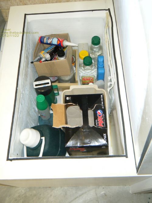

This is a picture of the finished product, not pretty but functional.

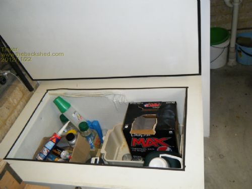

The inside box was then inserted and the top gap sealed with 3mm plywood, painted as above. This surface should be level as it makes the seal with the door.

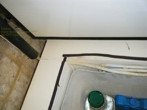

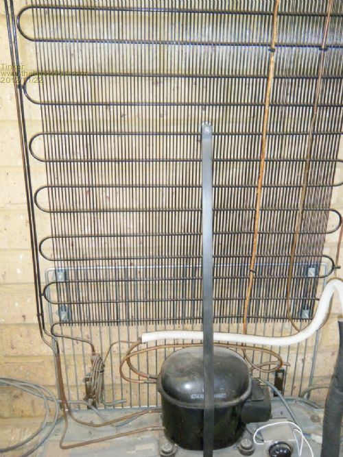

Below is a picture how the cutout for the cooling pipe & thermostat was arranged.

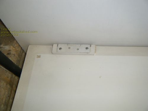

The lid was made similarly than the box, it must have a flat mating surface for the foam & thin rubber door seals. The hinges need to be extended to the top if this chest cooler is to sit against a wall like mine does, see picture below

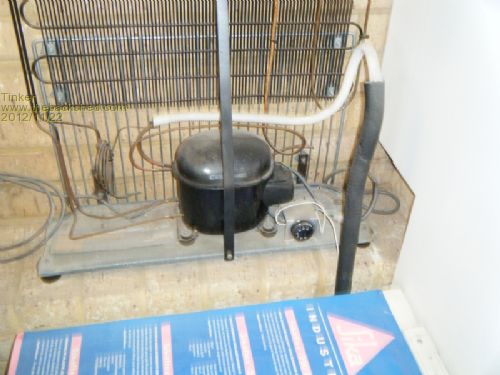

When dismantling the donor fridge great care must be taken to avoid excessive bending of the copper pipes. They and the attached condenser radiator will be very floppy and difficult to move with just two hands. A temporary frame to hold them is useful as the copper tube easily work hardens and becomes progressively harder to bend to the final shape. Worst of all, it could crack and then the greenhouse gas police will be very cross , beside a lot of dismantling time was for nothing so take care.
I made use of one of the fridge shelf grids to support the condenser in conjunction of steel strips & wall attachments at the top.

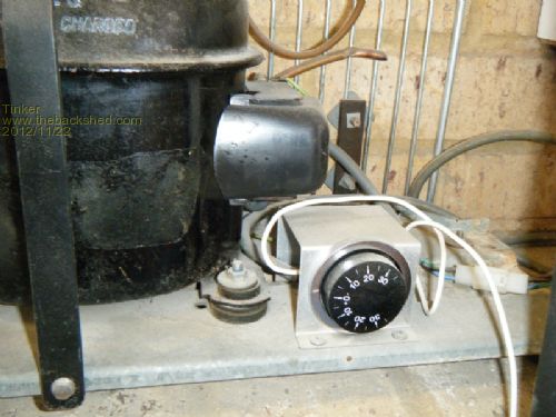

The thermostat requires special attention as it most likely will not easily mount externally with its existing fridge mounting arrangement. The capilliary tube on mine actually broke, rendering it useless, so I got an OEM thermostat, see picture, but its no longer listed in the latest catalogue of RS electronics.
If there are small children around a better enclosure than the one pictured is required as little fingers must never get near life mains voltage connections.

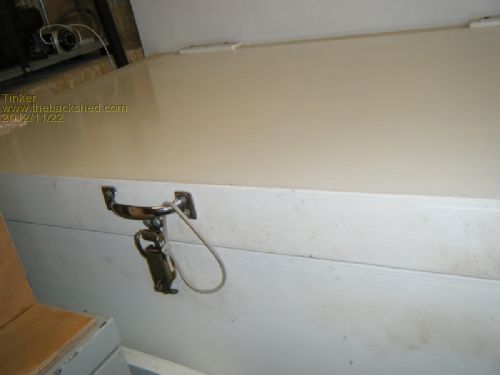

I use a simple latch to close the fridge door:
So, there it is, my home made chest drinks & shed stuff fridge.
