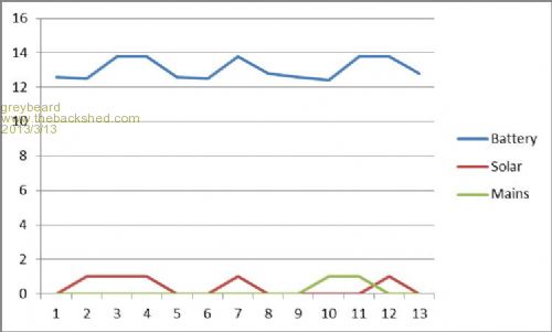

And a pic to show what I mean.
At #1 the solar starts charging the battery.
At #3 the battery is charged
At #4 the sun goes down
Invertor runs on battery until #6 when the sun comes up and the solar starts charging again.
At #8 it gets cloudy and the solar stops charging and the invertor is on battery.
At #9 the battery voltage is low so the mains charger starts to charge the battery.
At #11/12 the sun comes up and the solar takes over charging again.
Pretty much a mains charger that only starts when the battery is below a preset value and then stops charging when the battery voltage is above a preset value and/or there is enough solar power to take over charging.
