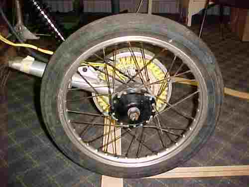

Hi,
I am placing an entry into an electric vehicle challenge & was wondering about the suitability of using a F&P motor as a hub motor (driven as a 36V stepper motor). Has anyone tried this & is it suitable?
Posts: 5199
Posted: 01:28am 22 May 2007
Yes I have tried it. See http://www.thebackshed.com/mackaysolarcar/index.html
We gave up on the idea after several month trying. Problems with the mosfets blowing. The mosfets work in a 3 phase H bridge configuration, the high side driver is a fiddly beast.
But I think it could be done, we just ran out of time.
