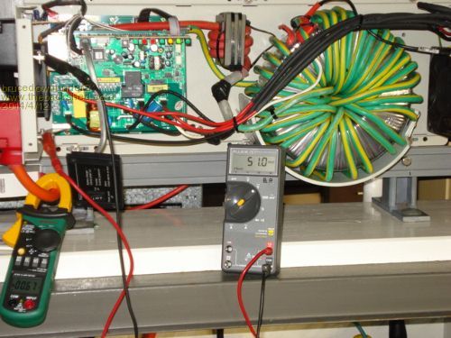

Hi Crew , I have a big 48v inverter wired into my system ..
It was drawing approx 230 watts ,just in the stand-by mode-not good.
So, along with the help of some very smart guys on the 'energy-matters" forum ,a few of us decided to try and modify these "power-hungry" inverters..
Most of the guys from this other site are very familiar with the Backshed and ,some are actually original members here.
OK, so, after a few months of fiddling and hospital stays, I finally finished the "conversion"
Guess what , I now draw approx 23 watts on standby--Thats a 10 fold reduction in standby power ,plus the 23 watts is all that is added to any load I now draw from the inverter..
basically, the "Toridial" transformer and the "squarish choke" is the parts I've added,discarding the original big heavy transformers..I rewound the "Toridial" transformer, thats 25mm square primary winding in Green you can see.
There is lots of "other" parts to this story ,but I'll wait and see if anyone is interested..
bruceEdited by brucedownunder2 2014-04-13

Well done Bruce, that's an extra 6kwhr a day to play with if my thinking is correct.
I take it there is a little more than the rewire of the toroid and the choke.
I am very interested in the details of your mods as I am looking at a standalone system myself and the more info the better, especially if I end up with a hungry inverter.

Thanks Bryan ,you have allways been a support to us guys on the back shed..
M. Del ,, first up mate, get a real name , like bill, jack, anything but "Sue".lol.
OK, not much in the electronics Dept. ,just getting the Toridial from a "inspire" grid tie solar inverter was the first thing, around $80 delivered.... strip it out of the box , strip the outer secondary winding off , and replace that with the huge 25mm winding that is now the primary..,about $20 from the scrap dealer.
Go to "energy matters" forum and look at the 61 pages of what we did -- takes at least an hour.
She's up and going been all day just consuming a mere 25 watts odd of internal power.
Bruce

Bruce, just out of curiosity: Normally toroidal transformers are held in place by a central bolt and large disk on top. There is no room for such a bolt with your conversion so how do you keep that big heavy thing in place?

Posted: 10:29am 13 Apr 2014
Hi Klaus,
You are right,there is no room at all ..It was very hard to pull,push the cable through around the last 10 turns.. And, this cable was not the muti strand super flexable cable that most electronics projects are used to.
The bolt --- Thats why i made that semi-circular waste water pipe support-Think it's a cut off from 300mm plastic pipe.
The finished Transformer weighs in at around 13-15 Kg's , so actually when she's sitting in place , she's not going anywhere . i didn't even use cable ties , just the ends of the stiff cable bolted in place kept it fixed.

Hi Bruce,
I gathered that's what that semi circle thingie might be for, just had to ask
So, weight is holding it there and its not some equipment you have to move around. But, does it hum or buzz when going?
I have not yet looked up the messages you mentioned on another forum as I'm only generally interested in what you did there. Earth wire might be cheap but has excessive stiffness for such a job - as you found out .
How many volts are in that winding?

Hi Klaus and Mark,
The humming , The "e" core ferrite former is in 2 parts , when together and passing current there could be a bit of hum, but mine is minimal,barely noticable at more than 200 watts.
No hum from the Toridial transformer at all.
Wire -- this transformer is capable of delivering up to 8Kw. So, with a 48v supply ,thats why the big primary winding- next time , i would buy welding wire ,it's more friendly in the bending dept.
Volts. the primary has 30 volts ,when the secondary is fed with 240vac.
Actually , around 1 volt per turn through the centre = 30 turns.
