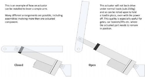

A crusty old linear actuator would do the job. say a 100mm stroke with non adjustable limit switches in the gearbox. they are slow but have plenty of torque.

Thanks for that. My original idea was to use a linear actuator ... until I saw the prices.
Also, I hadn't even considered whether or not a linear actuator could "back-drive" or even hold something in position with the power off :(
The wiper motor is looking better all the time. I have an old Morris Oxford in the backyard that is going to offer it's wiper motor for a trial.

I get mine from c band satellite dishes. second hand they are worth virtually nothing BUT most of them are 24 inch stroke. they are rated at 36 volt but should still work fine at 24 volt.
A standard duty 12 inch actuator shouldn't be any more than $70 new.
what about a power window mechanism? has that got built in limit switches?
