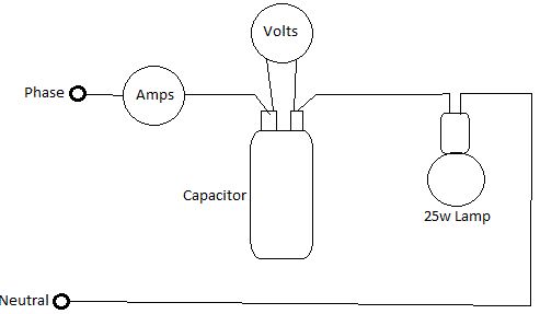

There is a fairly simple way to check mains rated caps. All you need is a 25watt lamp, a basic multimeter and a bit of a formula.
1/ Connect the circuit as shown with the capacitor in series with the lamp and a known AC voltage at the phase and neutral . Mains is good as it’s a known voltage and frequency.
2/ Turn it on. The lamp should glow. This will at least tell you there is something for the electrickery to get through.
3/ Measure the AC voltage across the capacitor and note it down.
4/ Measure the current through the circuit and note that down as well.
These are the only two numbers you need. Now to work out the value.
1/ Calculate the resistance as follows. Resistance = Voltage/Current. So if you have say 20volts measured across the capacitor and a circuit current of 0.1amp you will have a resistance of 200ohms.
2/ The capacitance can now be calculated using C=1/(2x PI x mains frequency x Resistance)
So 2x3.1415x50x200=62830
1/62830=0.0000159
This is the answer in Farrads. If you move the decimal point to the right by 6 places, you will have the answer in Microfarads. In this case near as damn it 16uF.

Fixed! First bought a new multimeter as I could not measure AC Amps with my $10 one. The new meter has capacitance included. The 12uF one measured OK.
The 50uF measured 3nF! The suggested schematic with lamp and the resulting calculations as suggested led to a weird 4000mF value and this is not an error in decimal places.
Anyway, the dead 50uF start cap was replaced with two paralleled 20+30uF starter caps from Jaycar and the motor spins again! The original 50uF cap fitted into a small plastic tube alongside the motor, the two and big new caps will have to be safely tucked away somewhere.
Thanks for help!
