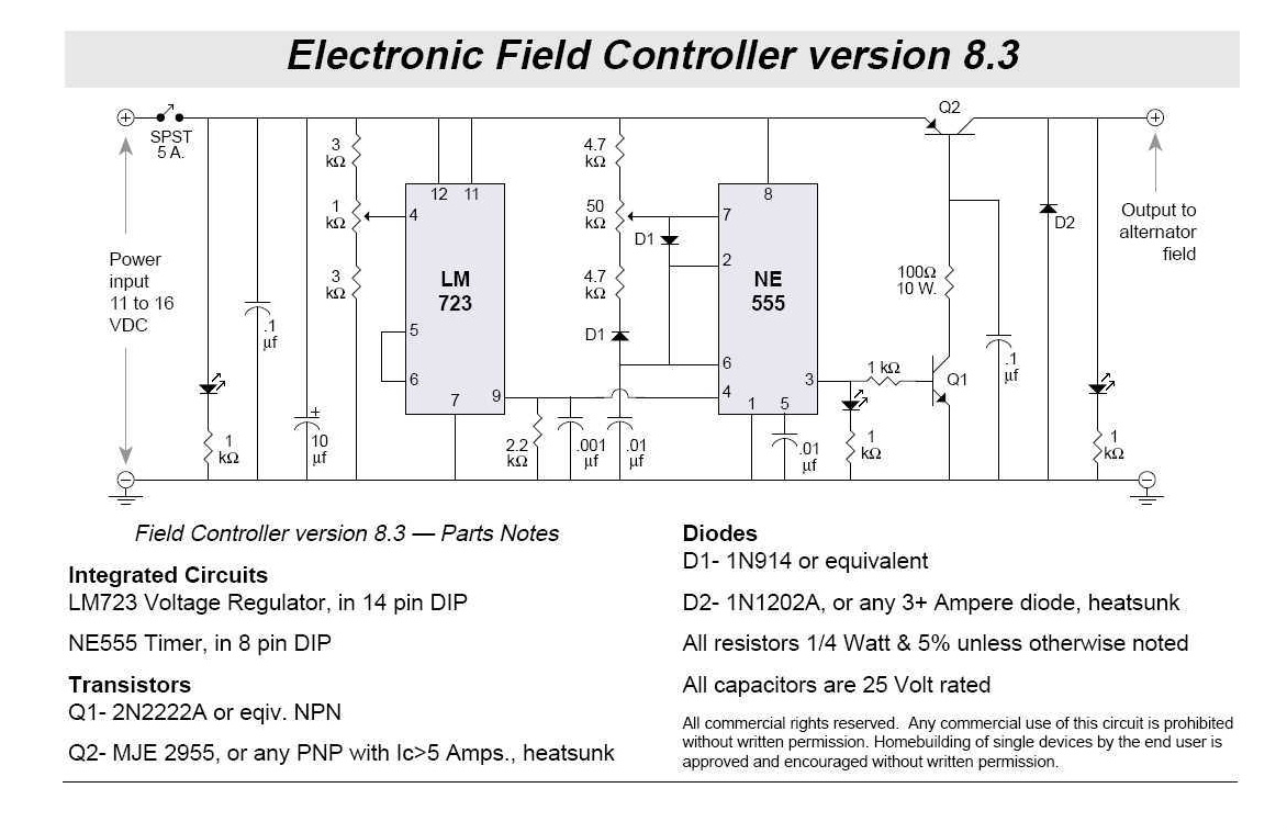

One more question, how can you modify a Delco 100 amp alternator to increase cutout voltage from 28 Volts to 31 Volts, the same cutout point as my sloar regulator to stop battery sulphation?
Roy.

The regulator can be screwed up to approx 30 Vdc, this is what we currently use.
Have been looking to replace the regulator with a DIY reg that will allow maximum voltage and current control similar to what you are talking about.
Kevin

Thanks for the reply, most helpfull, where can you find plans to make DIY regulator,?
Cheers.
Roy.

Roy, this a 12 volt version
from an article by Richard Perez 1994 in Homepower mag
Being mechanical and just dabbling at getting zapped,
I expect that the capacitors need to be 50 - 60 volt range.
The 3K and 4.7K resistors need to be sized for the higher voltage.
And Q2 might need to be stronger.
We need a voltage 27-33 volts
I hope that some electrical buff might be able to point us in the right direction.
Kevin

Kevin,
Thanks for the Info, I ahve a friend who dabbles in electronics, will show him the diagram and post you a reply when I have some info,
Thanks for your effort,
