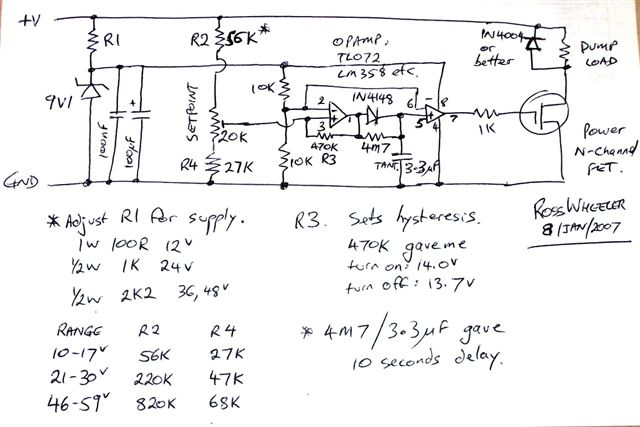

does anyone know of a suitable shunt regulator to protect a battery bank from overcharging. Ive built a f&P wind generator - set up a 12v battery bank using forklift 2v cells connected in series. Oatley no longer supply the K220 kit and the commercial ones are expensive. Im at a bit of a hault until I get it sorted.

I think Gill has a spare 220 or you could use the new oatley one here
Or you could build the one RossW designed

The Oatley one is only rated at 300w
Does Gill have any contact details
I would rather build one in a kit form rather than making one from scratch
