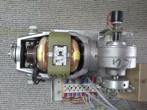

Hi all
Wondering if anyone would have an idea of how to wire up this salvaged motor, it has 2 wires to the brushes via a small transformer and two to the windings of the stator. other wires go to a rotary encoder. Rotor coils seem ok by resistance test.I am only interested in running this in one direction and at a constant speed. Detail Plate reads Groschoop & Co 4060 Viersen 1, 220v, 0.62A, 2000min-1, 80 Wcosp. Can't find any info on the net

Assuming (now that's a bad phrase for a start :-) it was from a devise that did go in both directions, the field and armature windings will be terminated separately. The field is normally in series with the armature. Direction is changed by reversing the field windings. Start with the armature and field windings in series as is the norm' and see how that works for you. Oh. don't touch the red wire (brown, white or black depending on your country) coz that's the one that bites. Also, the 'small transformers' you mention are chokes, used for a bit of AC noise suppression. Good luck.

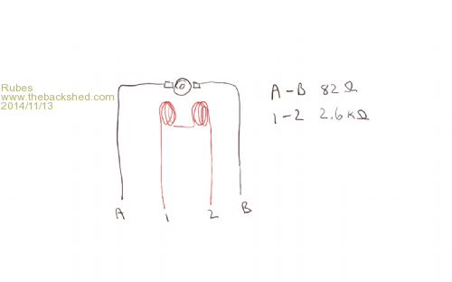

Thanks for the reply Pete. Just traced the wiring by continuity and the 2 fields are in series as is the armature which makes it impossible to go field1-armature1-field2-armature2? am I right? see sketch of circuit as it stands. Only way would be field 1-field2-armature1-armature2 unless I am getting it wrong completly. Thanks Cheers

If it were mine I'd power in A & 1 and join 2 & B.
if it rotates wrong way power in A & 2 join 1 & B
because it has commutator and brushes it will run on DCEdited by rustyrod 2014-11-15

Rubes, what you show as *two* fields is considered ONE winding. It has to be arranged that way to create a N & S pole (alternating) between them.
Please consider the advice above (joining A&1 + 2&B as a BAD idea. While this *might* work on low voltage DC - putting the full mains voltage across the 82 ohm armature is just asking for the magic smoke to come out.

Power in Active to A
Neutral to 1
and join 2 with B exactly the same as any electric drill/angle grinder.
I am sorry I did not make myself clearer.

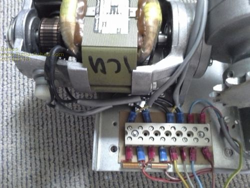

photo looks like (I say looks like, need underside photo) from left
- terminals 1 and 3 are to the brushes
- terminals 5 and 6 are the fields
-- the yellow and ? blue twin wires would not be needed
remove the chokes and all other wiring on this side of terminal strip
the chokes hanging out like that are waiting to bite you
perhaps active in terminal one
neutral in terminal 6
join terminals 3 and 5
IMPORTANT screw a good earth to the frame of the motor
if it runs the gnorw way swap the black field wires in 5 and 6
IF you need to use all those other wires for what you are doing you are on your own.Edited by rustyrod 2014-11-15

Hooked it up this morning as per Rustyrods suggestion, First tried DC starting at 12V and working up to 50 then on to 220 AC ,nothing, not even any smoke, bit disappointing actually.
Anyhow after some more reading it seems the windings should not have a resistance value of anywhere near 2.7k so I guess the motor is dead, I hope to somehow use the gearing mechanism.
I have learned a fair bit from this exercise so not in vain and thank you to all who took the time to respond. Edited by Rubes 2014-11-16
