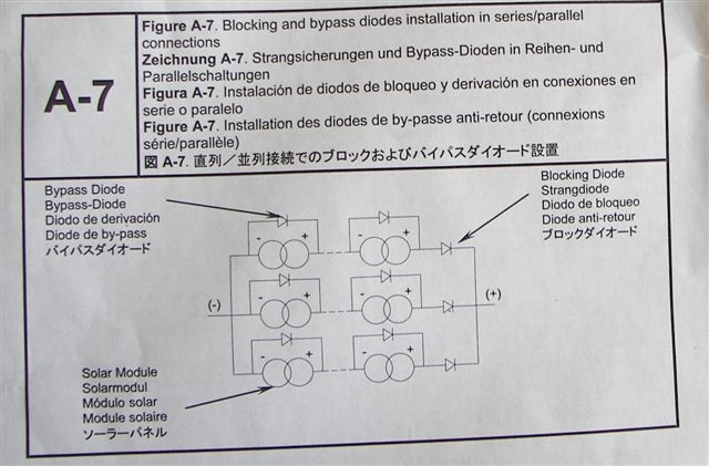

Hello Mick,
Here's some info extracted from the instruction sheet from BP for their "Crystalline Silicon Photovoltaic Modules" (Solar Panel range[polycrystal])
For my new 80w panels they reckon they are already fitted with by-pass diodes, but for the life of me I can't see where they are located.
Sorry the Table C-1 they refer to does not exist on the Instruction Sheet.
Cheers Gill _Cairns, FNQ

Gill the sharp NE80 has bypass dioded in the Jbox I dont sell bp gear so have never seen the pics you posted thank you very much for that I will visit J c*** today and see what I can find. I just wish I could talk him into a controller but he's set in his ways
Thanks again Mick
