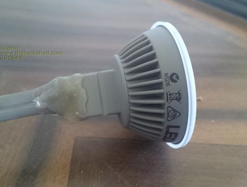

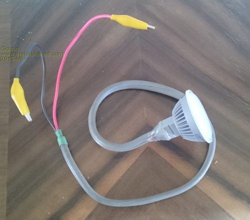

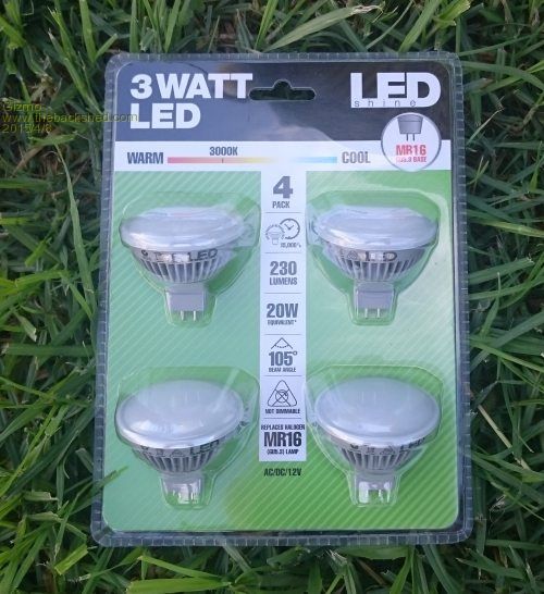

Bunnings hardware have been selling these 4 packs of 12volt 3watt down light LED's cheap for a few weeks now. $10 per pack, so I bought 5 packs. They also have 240v LED downlights ( different connector ) for the same price, so grabbed a couple of those too.
I had to rewire my house recently with new 3 core wire, and saved the old 2 core wire. I've been soldering the 12v LED's to this 2 core wire and sealing the joint with some hot glue. The old 2 core wire is easy to bend and will retain that shape, within reason.
And these are some of the ways I've used the LED's. A handy light for clipping on a 12v battery.

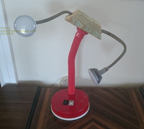

A 12V lamp, I have a few 12v outlets around the house.

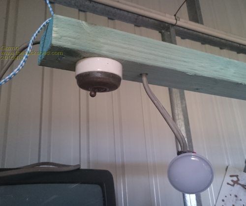

A work light above a work bench. Same deal, I have 12v outlets all over the place.
The 3 watts of light is more than I expected, and it only draws 300mA per LED. Next up I'll be adding a couple to the ride on lawn mower.

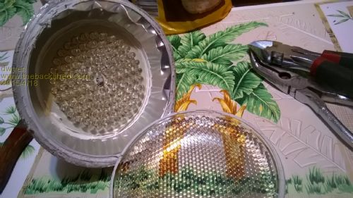

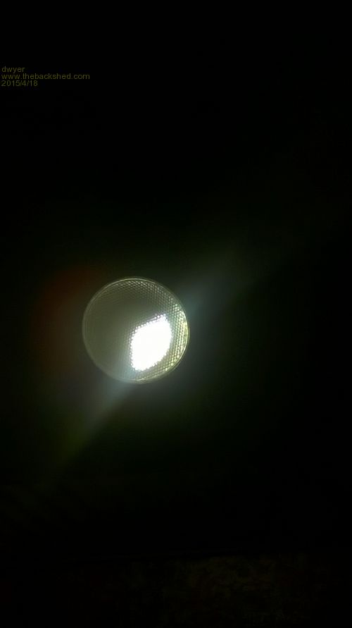

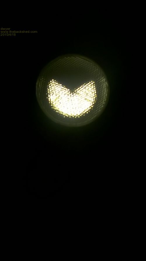

Hi Gizmo

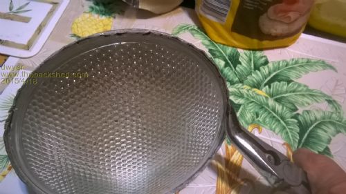

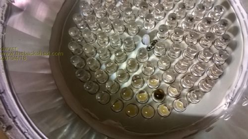

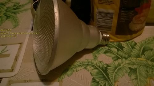

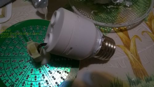

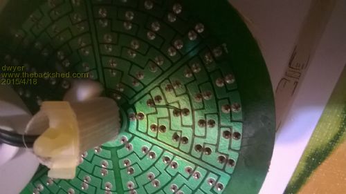

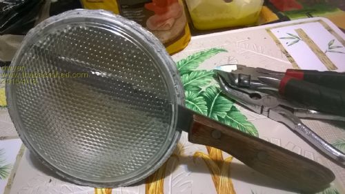

I saw this at Bunnings hardware about 10 days ago and never thought of buying 4 packs of 12volt 3watt down light LED as however some months ago i bought three 6 watts LED outdoor flood light 240 volts and only last fews months as i pulled it apart as two of LED was blow. I will never buy it again as there are two many LED so when one blows all blows . Will post some picture soon

That is brilliant work.
I am guessing that the old wire is 1mm twin for lighting circuits, and is solid-core?
Never thought of using old wire like that, and I have a box full of off-cuts...

Hi Ian
Will see how long they last. I've been using them for a few months now, so far so good, and they dont get hot so should last longer.
Yep Grogster, its old light circuit wire, solid core. Nice to work with.

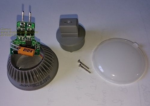

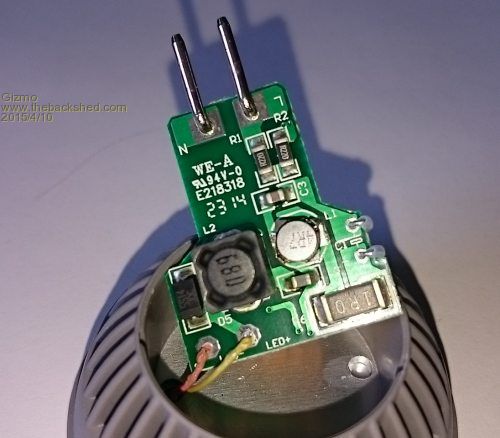

Hi Yahoo

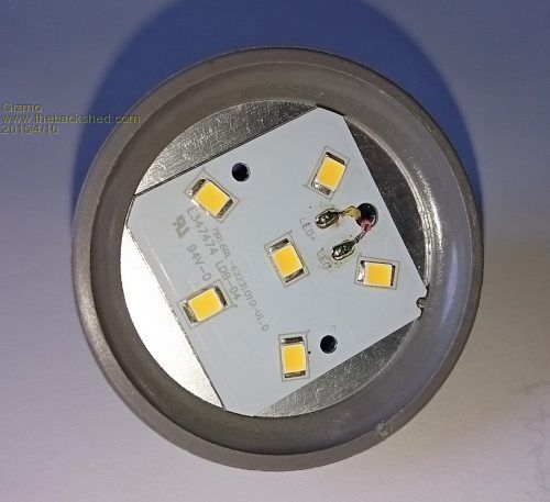

Just pulled one apart to have a look. I was expecting to see a few LED's and a series resistor, but found 6 surface mount LED's on a aluminium heat sink, and a circuit board containing a full wave bridge, IC, couple of inductors, 330uF 25v cap and a dozen other components. Construction is good. So good, that I'm going to buy a few more
Will take some photos later and post.

Posts: 5199
Posted: 06:15pm 09 Apr 2015
Pics as promised. To open them up, I prised off the front diffuser cover and undid a couple of screws, easy.

i wonder if that 8 pin chip is a dedicated LED driver or if its just a bog standard switched mode power supply chip.

  Quote  i wonder if that 8 pin chip is a dedicated LED driver or if its just a bog standard switched mode power supply chip.
Really who cares at the price they are sold at.
To me it looks to be a well laid out tidy circuit board, and for that reason i would think Glenn has discovered a gem of a item.
Then only time will tell, but for the cost its well worth the experiment to test them out, as its a little cost to gain a low energy result.

ooOOH! that looks impressive.
I hope they are on sale in regional SA, they would be just the ticket for a workbench lightbar.

Powernut its a BP1601. Looks like a dedicated LED driver IC, I found this....
"BP1601 is a step-up DC/DC converter designed to drive high brightness LED from 4.5V to 24VDCinput voltage . Typically in 12VDC input voltage, up to seven 1W LED strings is able to be drived.
BP1601 works in current mode to control LED current, it set the LED current by sense resistor, this low-side sensing strategy is used to minimize the power dissipation and improve system efficiency.
BP1601 detects the OV pin voltage to provide open circuit protection.
The BP1601 includes under-voltage lockout, current limiting and thermal overload protection preventing damage in the event of an output overload.
BP1601 is assembled in SOP-8PP package, which provides excellent heat dissipation and thermal" (ref)
Interesting bit of gear.
