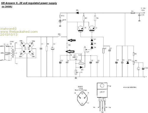

I have this circuit build
Its working fine but!!!!
for the second time by accident I shortend the positive and negative , but the fuse didnt blow.
Each time it blew a tip3055 and the replacement tip41c
it also blew the 5 k potentiometer.
the fuse is in the right place as shown in circuit
any suggestions please

Fuses are not fast enough to stop semiconductor devices from blowing up.
What have you set the current limit to? The current limit part of the circuit should provide protection against accidentally shorting the output.
Are you using a fast-blow fuse?

OK, car fuses are generally fast-blow.
You should start with the recommended value.
  Quote  3 Amps @ 47 Ohm
Try a fixed resistor if you can't get 1 Watt pots.
I have built many power supplies in the last 40 years, but it is not readily apparent how the current is limited in this circuit. I suspect it is limited by the gain of the 2N3055 transistors and the allowable base current controlled by P2.
Generally, one senses the current flowing to the output and use that as a feedback signal to control the series pass transistor.
Google <images current limited power supply> and look at this current limit example Edited by davef 2015-06-11

A problem with incandescent bulbs, if that is what you are using, is that until they start glowing they look like a much lower resistance then you would calculate from the wattage.
Also, using a different transistor (TIP41 versus 2N3055) could result in different limit currents ... in that original circuit.
Yes, you can have a totally protected system with the correct implementation.
Again, fuses are NOT going to stop this from happening.

  Quote  i wronly connected positive and neg to load.
To an incandescent light? I don't understand how it would make any difference how you connected that to your power supply.
  Quote  but what is the point having this fuse in this circuit if it doesnt protect it.
I cautiously suggest that maybe the circuit design is not "bulletproof". Also, as I suggested earlier you need a circuit that incorporates feedback. IE a properly designed current limiting circuit.
  Quote  could you explane how?
One option is to buy a proper linear regulator IC hopefully that could drive external transistors for higher current capability. Try looking around the ti.com website and find their design tool (workbench?)
There are other forums where you are more likely to get help for this topic, ie here
Or, try to get recommendations for discrete circuit designs that are known to work.

Hi. My power supply stopped working
And I am lost. I have power going in untill R9 resistor.and maybe only a volt orso going to lm317. Resistor is changed and I checked all caps for a short.any help appreciated.
Pete Locke
Joined: 26/06/2013
Posts: 186
Posted: 09:05pm 11 Oct 2015
Simple test. Lift one side of R9. If you have built the circuit per the original post, the LED should light up. Measure the resistance of R9. Better yet, with the regulator side of the resistor lifted (de soldered) from the circuit, what voltage do you get. Given the symptoms you describe, the regulator is dead. Also, just looking at the circuit, with a short circuit presented to the output, the LM317 is going to try straight away to raise the base/emitter voltage (current actually, but that's getting above what needs looking at here) to bring the output voltage back up. This will exceed the 2N3055 (TIP42) b/e limits VERY quickly and out comes the smoke. Also if you are using an automotive fuse, they are actually a VERY slow blow fuse. That fuse should be placed at the output of the main smoothing capacitor. A fast blow fuse in the output side of things should be used. Might help. Boot-strapping a regulator chip, which is what has in essence been done with the circuit, is a perfectly good thing. Very good concept used in all sorts of applications. But the regulator is 'blind' to the output of the power supply, being shielded from view by the output transistor. It can only see the base of the output transistor. No problem, as long as there is fast output protection provided. An automotive fuse will not provide that. The circuit as shown is an adaptation of a well proven design when used with proper output protection, and within its protection limitations. If you are using it as a bench supply to power experiments, I would suggest that using something as simple as a correct wattage light in series with the output will save you a lot of component replacements. Good luck.

Posted: 10:51am 13 Oct 2015
before the R9 resistor i havefull input voltage, after the r9 only 0,8 volt.
i removed the r9 resistor and it tested ok, but replaced it anyway with a new one with same vallue.
I also eliminated the the 2N3055 transistor from the board , but just dont get it why I suddenly only get 0.8volt going to lm317. I also removed this transistor and tested perfect .again to be 100% sure I replaced this lm317 also with a new one.
it was working before with this setup.
cheers ron
irishron40
Joined: 22/09/2014
Location: Ireland
Posts: 254
Posted: 12:24pm 13 Oct 2015
problem solved/ the r9 had blown and i replaced it, but for some silly reason I made the mistake to replace the 47 ohm one with a 47 k. the reason it blown is that i was drawing to much current and its only a 1.4 watt one insted of a 0.5 watt one
