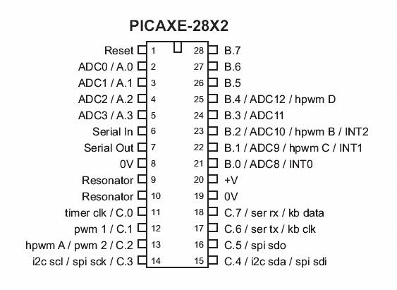

I intend to use a picaxe 08M as the building block for a multi channel logger. Now that I have found a way to digitally transfer analogue data between micro's. No code timing problems and electrical isolation problems is solved. I have maintained the 10bit resolution as well. If the big brother AXE 28X2 becomes available, with 12 analoge inputs, the data logging will be a snap.
here is a pinout of the chip.
The chip above is not available yet, so I will look at a retrofit system. A multplexer added to a Jaycar available, Velleman USB experimenters kit. I was having trouble with ground loops and related offset errors, but now My original VB6, 16 channel logger can be used.
The reason I suggest an alternative to Gizmos logger is the many more channels that are able to be recorded. My version of VB6 is the enterprise type and I have not been able to read a COM port, but USB is not a problem with the functions velleman provide. The velleman USB drivers support > 100 readings per second.
