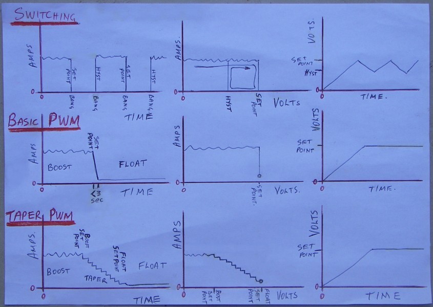

For those trying to follow this thread on PWM regulation, here's a few little graphs for those(like me) who need a little visual input too.
WIND GENERATOR REGULATORS
correction: the two little circles should sit on the 0 line
What we all use(to my knowledge) is the top one.
Gordon's project is the middle one. You Beauty!
And I am about to attempt the lower one.
The area of most concern with my proposal would be displayed by a large circle in the middle graph also shown as a ripple in the Float lines of the two outer graphs.
I hold the optimistic view that it will be well within acceptable levels, so I have to make it and see.
I am a plodder at making things, but it will happen soon.

GWatPE
Joined: 01/09/2006
Posts: 2127
Posted: 02:43pm 24 Nov 2007
Hi Gill,
With reference to the code contained in the above link.
What is Max amps referring to. I assume it is mill output amps?
I have looked at the code and I can see that below Volts = 350 then all power goes to battery, no dump load ON, then between Volts = 350 and 395 the code throttles power to the dump load proportional to the power from the mill. Above Volts = 400 the code controls the PWM to maintain Volts at 400 by throttling the dump load.
can you give approximate battery voltages that you would expect the 350 and 400 settings to be?
Would the float section of the code relate to say a float voltage on a 24V system of 27.6V?
cheers, Gordon.
