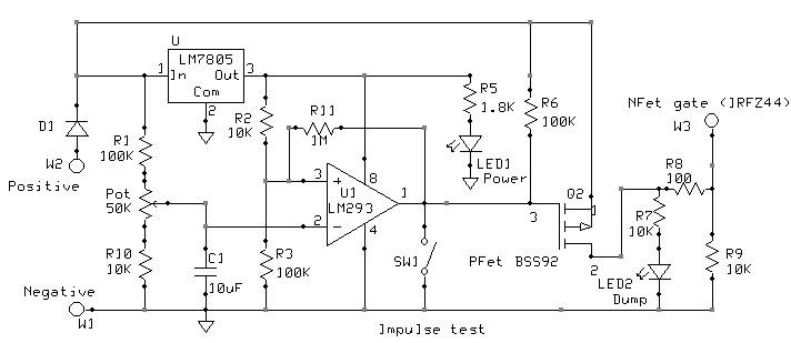

Hello all. I want a simple circuit to switch on a dump load at a preset voltage. I don't know much about electronics, but have tried to design something as follows.
Any comments or suggestions would be much appreciated! Thanks in anticipation.

G'day South Easter,
What do you mean don't know much?
The circuit mostly looks OK with the exception there is no positive feedback to give some hysteresis for switching.
RossW has posted a proven simple circuit much like yours in this thread here
I cannot seem to open the pic of his circuit. If you have the same difficulty, give Glenn a shout as sometimes the gremlins have a wee party.
Cheers Gill _Cairns, FNQ

Hi South Easter,
A word of warning re- driving a mosfet. Most power mosfets require a gate voltage of 12-15V to turn on hard. Only drive logic level devices from a 5V rail.
cheers, Gordon.

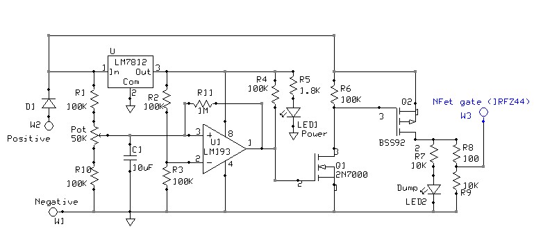

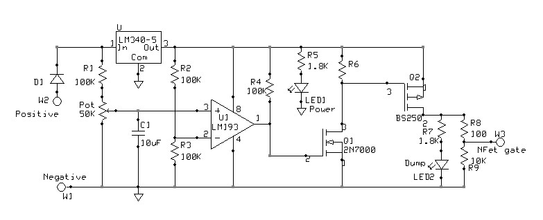

Posted: 05:51pm 25 Nov 2007
Thanks for the feedback. Here is a modified version which is intended to drive the fets harder.

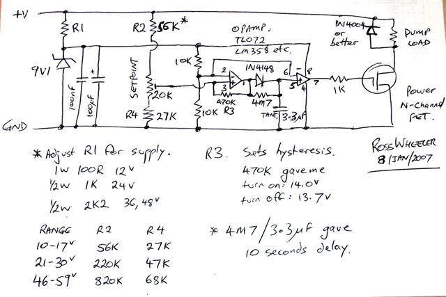

This is the one RossW designed.

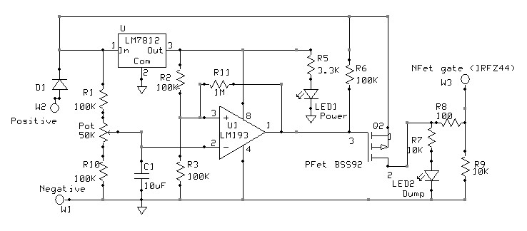

Posted: 08:37pm 25 Nov 2007
Thanks Highlander! I will study that circuit...
In the meantime I had reworked a bit as below. Its skips out the small Nfet by switching inputs to the comparator - thanks again for your comments.
Also, this way the output of the comparator is floating, and so I assume draws minimal current when the dump is off. I have chosen the resistors large in order to minimize quiescent power use - I hope not too large?

I see you have modified to use a 12V reg, reversed the logic and included some positive feedfack.
What voltage can the comparator withstand on the output? Is it an open collector output?

I use 24V, but would like the circuit to be usable for 12V by cahnging a resistor or two.
The 293 is open collector as far as I know. That lets me add the test switch as per the latest version below.

Hi South Easter,
you have changed R2 to 10k. The 1M positive feedback will have little effect now.
I could not buy the wire in Australia, so I sourced overseas. This was pre internet like we know it now. The wire I used has 2 layers of cotton insulation. I still have not been able to source a local supply and have lost details of my original purchase. I do not have enough wire left to do much with, so my genny is a one off.
You are saying there is a 10mm air gap between the magnets. This will reduce the power significantly, but this will also reduce the eddy currents as well. Not all bad.
You may want to place a zener gate voltage protection across R9 and increase the value of R8.
I do not drive a mosfet this way, but this will work for ON/OFF, very low frequency switching.

Posted: 04:01pm 26 Nov 2007
Great thanks! So I change R11 to 100K? And change R8 to 500Ohm(?) and add a 30V(?) Zener across R9.
I am worried from your comment that I am driving the mosfet the wrong way... could you perhaps mention a better way? For a dump load, the frequency may be quite high. Unfortunately my knowledge doesn't extend to being able to work out the hysteresis or frequency under various conditions.

Posted: 11:55pm 26 Nov 2007
Hi South Easter,
It is not as simple as that. For reliability the FET gate should be about Max 18V. Work out the series resistor R8 to give a couple af mA at the Max voltage you would expect. To reduce oscillation frequency adjust the filter cap C1 to give a time constant of about 2 seconds. somewhere between 22 & 47uF. The feedback resistor is chosen to select the hysterysis voltage amount. I would use trial and error, but 100k is a start.
I prefer to use SSRelays for slow switching speeds. Most of my designs are now PWM ccts. The designs are too complicated to explain here.
