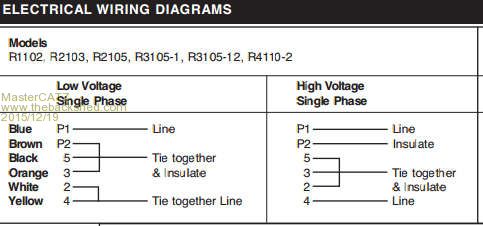

I have a gast regenerative blower
http://www.gastmfg.com/support_documents/70-6000rev_L.pdf
now where I am confused is on the motor the label has
P1-line labeled as L1
P2 - Insulated ( Done)
5,3,2 tied and Insulated ( Done)
4-line labeled as L2
what I am unsure about is what wire ( L1,L2) goes Neutral Active
single phase
or will it not matter ?
also I am unsure if I can Ground this ?
to be honest I was quite surprised to NOT see an earthing connection not that it did not stop me bolting one on

The basics is its a DC motor so it will make no difference to which terminal (L1 & L2) the active and neutral goes to.
With no earth it would fall into the category of a double insulated item, which requires no earth wire, much the same as any mains drill or grinder you will buy nowdays.
Do not add a earth if it was not there to start with.
Pete.

It would seem I have given you some not totally correct information.
I had missed the link to the blower when I first commented, on checking the link the blower is a induction motor and not a DC motor.
The missing earth is required and would have normally be connected to the metal J box mounted on the motor.
I have 2 blowers here of the same style just different brands than yours, both of mine have a start capacitor, so you need to check for any 2 existing wires that are not a part of the wiring diagram given or they may be in a different location and not in the Jbox. (side of motor etc)
Your wiring would be for the High Voltage method (240v) and not the Low Voltage method (120v)
Pete.

damn I snipped my earth :S
motor started fine without capacitor's
how ever it's only 100 watts ,
will see how the 200 watt version I have goes another day
I will re-solder the earth wire back on thanks for updated info
yes wired for High Voltage 230V (AU)
