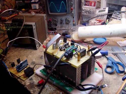

ok I persevered and did the jpg conversion so here it is now
Note the there is only three chips, all plug in.
The 8010 can be replaced by the folks on the mite board.... they are smarter than me, but a i figure a jump table and scaling is really all that is required to make a useful chip.... but at $1.50 and less per 8010... I just could not justify the programming on even a nano... I cant get a burnable chip for that kind of money.
This route is a close to home brew as you can get without programming a chip yourself.
A proper buck converter or similar would be better so as you can drive the fans..... but also a tiny 240v transfromer will do fine too.
.........oztules

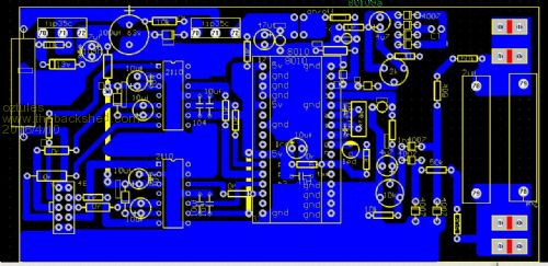

I think this is the last version of the ESG002 pcb for comparison.
what does VS1 and VS2 do? are they sensing the crossover point? there are no components just wondering if it is important that they have similar paths.

Posted: 05:28pm 09 Apr 2016
VS1 and VS2 are simply the floating "source" points for the 1Ho and 2Ho gate drives ... ie gate voltage reference point/s.
The charge pump pushes the voltage beyond b+ to drive the gates of the high switches, and this is the gate reference at the source of those high side fets... ie when the fet turns on, there is no potential between drain and source, so source will be at b+ when turned on... so we need higher voltage to hold the gate on.
The low sides use ground for this reference.
I believe normal analogue practice is not required here, and ground loops are acceptable... you want 1's and 0's @ 12v.....so noise on the line is of no interest.... within reason.... so earth points everywhere are best.
Yes that is the last version I think... works perfectly well, but I have swapped to 8010 alone now.

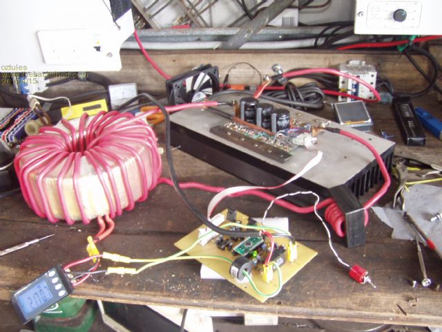

You mean like this one I did yesterday Tinker?
Yes Grogster... add tranny and batts and box.... should make a very useful little unit.
You may still need to render the 393 inoperable for torroid use..... they don't tolerate spurious pulse waves from the current shutdown system they employ.

Posted: 12:14am 16 Apr 2016
Nah Oztules, mine looks nothing like your idea above .
Give me a day or two and I'll post pictures of it assembled but without some of the parts I'm still waiting for.
I would imagine there are many ways to do what I mentioned earlier.
I see that you now have 5 turns around that ferrite choke, did you notice a worthwhile improvement from the 3 turn version (with obviously thicker wire)?
Also, where does that ON switch connect to? Just applying +5V to the temp sense input to activate it?

Posted: 11:18am 16 Apr 2016
Keen to see your unit mocked up then...
yes, I use the temp sense on that board for shut down, and the temp probe can be paralleled anyway, so you don't loose function either.
The inhibit works fine too, just didn't incorporate it into the board because of the blow ups originally..... gun shy. But later tested it, and it does not cause the torroid to throw up.
The 5 turns was because I had under sized wire, so it fitted.... it does help a little, three works fine, 5 works a little better, but not enough to chase unnecessarily. If I had the ecores in abundance, then I would use three turns around two formers....
Yes the transformer is the difference between a solid performer and a wannabe.....
