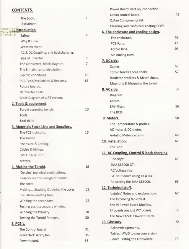

The detailed book/manual, 120 colour photos, 76 pages, is about my construction of a 6kW OzInverter, and the Big OzInverter, with chapters for each distinct construction stages. I have also added separate instructions and appropriate comments from ‘Oztules’, who’s jottings, 60,000 words, are open source on the World Wide Renewable Energy Forums … http://www.anotherpower.com/board/index.php …….. http://www.fieldlines.com/index.php , and http://www.thebackshed.com/forum/home.asp
When I get the PCB boards back from the manufacturers, just 20, and tested I will put a link up on our site and hopefully, with permission of the Moderators, post a link here.

The Book Index....

I have talked to the 3 most important World wide Forums Moderators and they understand where I am coming from and that this OzInverter should be published and OUT there.
But I am not keen on downloading PDF as its easily hacked and sold on by the unscrupulous, and I do not have the necessary Police-ing facilities.

Hi there.
Book loooks FANTASTIC!
Well done, you.
I know where you are coming from on the PDF, and I also think you should NOT offer that at this stage. To paraphrase you for a moment, it is really easy for anyone with a flatbed scanner to scan a printed copy and start selling off electronic copies of something they did not even write.
Ill-gotten gain is what it is all about to some - it sucks, and I totally understand your reasons.
I would like to purchase a copy of the book though, when you are ready to sell.
