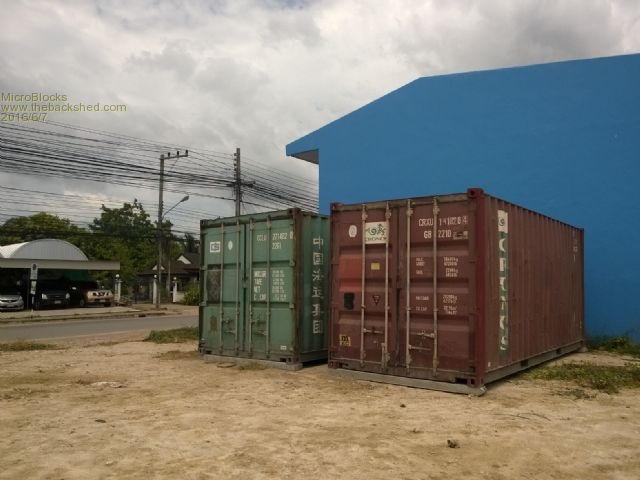

Here is the situation (2 containers for a workshop):

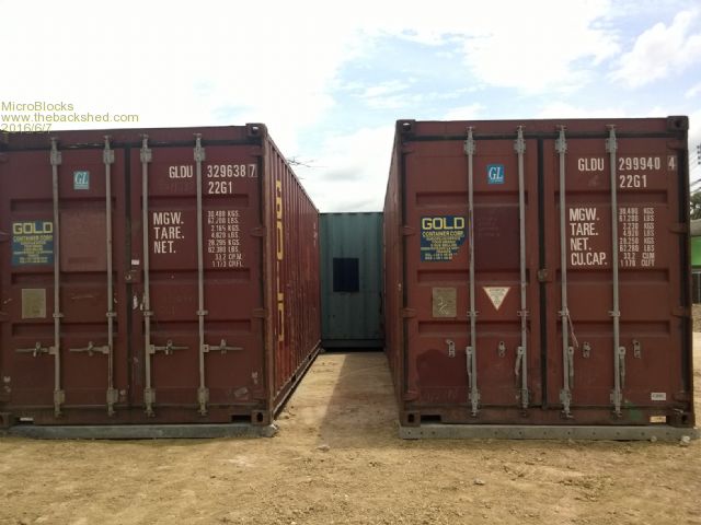

And about 15 meters from that (3 container in a 'u' shape):
Electricity will come from the pillars you can see in the picture. There are four wires so it is even possible to get a 3-phase connection, which might be useful when i am adding some power hungry machine like a vacuum former.
