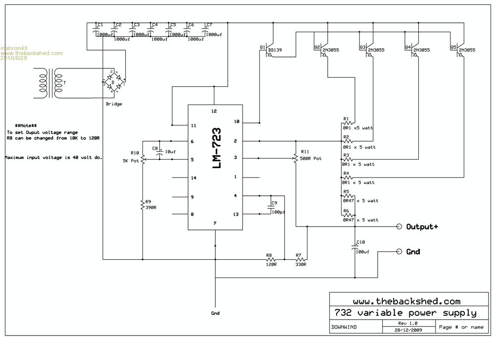

Hi. I just have one cap left to be fitted but only have a 100pf ceramcic cap?
would it be allright to use a ceramic in this application on pin 4 and 13 on the lm723?
as I only have a ceramic one of this vallue.
thanks
ron

yep, ceramic should be fine in that application.

For ease of construction, I use TIP35C instead of 2n3055.
Last one I did had 8 transistors on the output for 80 amps outputs... much easier with TO-247 shape... would not like doing that with TO-3... just a thought if you have not done the hardware yet.

I have allready used 4 tip41C transistors.
thx for your advise.
