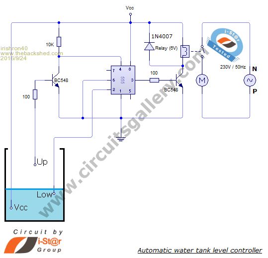

Hi Just a question hoping to get answer lol.
I build a system based arround a ic555 timer to control pond water level.
i have a red and a green led connected to system.
when water level is ok green led comes on, but I notice that the red one also lights up a little due to leaking current.
Is there a way to iliminate this?
thx
ron

Please provide the circuit,

And a 555 for level control...? Yep, would like to see the circuit.

I made 3 intergrated circuits. also a dry run.
All working perfect. an led could light up on micro amps and I like to iliminate that from happening.
thanks
ron

Ok. But where do you have the LED's connected? They don't appear on the circuit.
