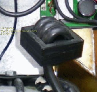

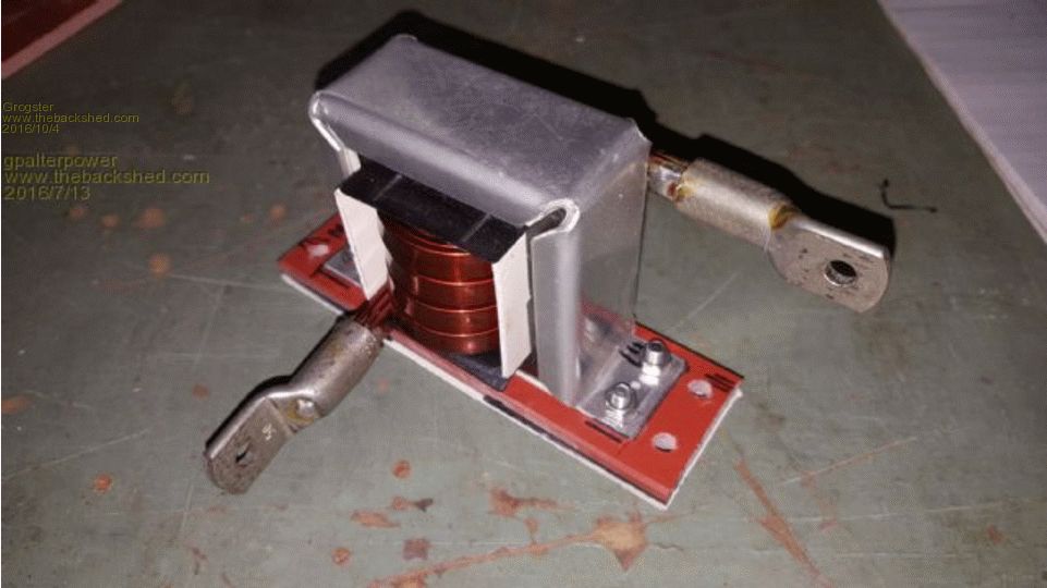

Posts: 10072
Posted: 01:18am 04 Oct 2016
Yeah, I think I have that diagram wrong - the "Big inductor thing" is supposed to be on the PRIMARY.
I am talking about these things:
Those images stolen from other threads here.
Is it not that mission critical?
Just at least three turns inside the ferrite core?
I am wanting to know how important this part is to get right, or if it is reasonably forgiving, so long as you have one there of some sort.....

oztules
Joined: 26/07/2007
Posts: 1686
Posted: 09:13am 04 Oct 2016
It is a tiny inductance.... too small to have any effect really on the 20khz
It is in the region of 12-20 uh.... not critical after about 12uh.. a bit more is better , too much seems to reverse the effects.
I don't know why it works so well... it may have something to do with switching losses in the fets, and this small inductance allows the switch to get fully on before the current really gets going... cant see how else it can make a such a huge difference, with such a small inductance. I think it was windspeed that promulgated this theory, and I can't think of anything better.

Posted: 12:38am 05 Oct 2016
If you use round cable of a decent size then you are limited to 3 turns and it works well.
If you are using rectangular enamelled wire you can fit 3.5 or even 4 turns of 60mm sq area max and it works marginally better. A fair bit of work for a small gain .
Round cable can be wound on by hand, you'll need to wind rectangular wire on a lathe or such.
Buy the cores with the plastic bobbin if you get them from e-bay.
Cut the bobbin carefully into a right and left half (see my tread "tinkers inverter build") and you can then wind your coil on a strong dummy center and insert the fragile bobbin halves when the coil is finished and then stick the lot together with epoxy.

Posted: 09:04pm 06 Oct 2016
Grogster,
When I wound mine I found that I could get nearly 4 1/2 turns on the ferrite core. I was thinking that 3 1/2 was optimal, but fitted the extra only because I could to fill the gap and to prevent the turns being too loose. My stand by current is only 0.7 amps on 24 v so im not sure if this is due to the extra turn or not but Im pretty happy with the outcome.
Now I dont know either how they work but is amazing that it does and it definitely made a difference. I tried the inverter without it jumped back to 4.5 amps. Eeeeh! Power hungry.
On another note I was wondering if the ferrite E core could be replaced by a small torroid, say bout 80mm dia. I have a spare one from a speaker amp setup and am contemplating stripping it down, rewinding with 50mm and giving one a go in my old hungry "power star" inverter as an experiment. I have read the thread from the Energy Mattery forum ...(https://forums.energymatters.com.au/solar-wind-gear/topic3344.html) site but a toroid was fitted firstly in place of the 2 E and I cores before any other changes/additions were made so I guess we'll never know if by just fitting a choke will make any difference to the idle current. When I have a spare weekend ill give it a go.
