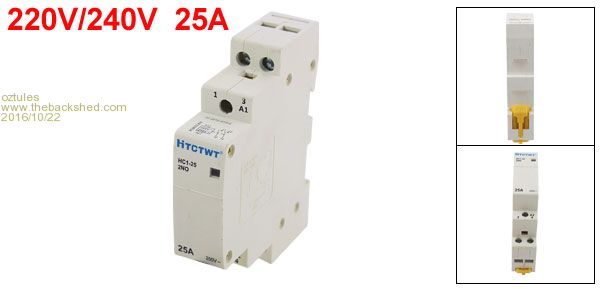

I would use this sort of relay...

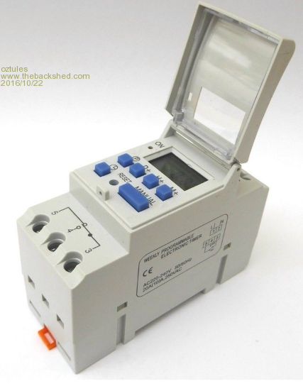

This sort of timer .... should only need one as it has multiple multiple programming. and does not forget programming when power goes off for some reason... self resets when power resumes.
I note there are some of this design that claim 20 amps, and this would mean no relay required for a 2hp centrifugal pump motor

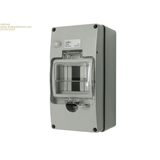

I would keep all components in this style enclosure ... and all at 240v not 12 or 24 etc.
This sort of box has water proof ratings, and it has the din rail so all the stuff will all just clip in. There is room under the rail for wiring as well between items, and gland exits too.

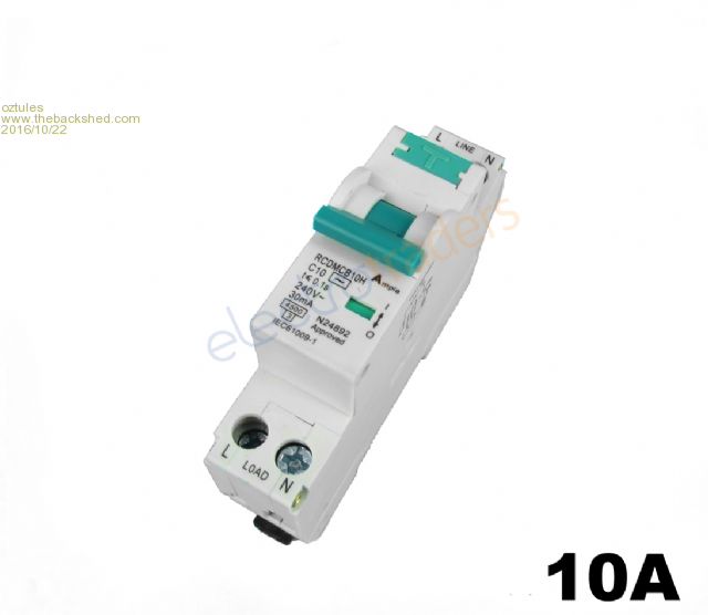

and a 1 pole rcd.... just because you can

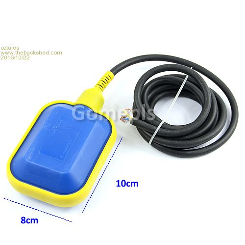

Mount on a stand pipe/pole next to pump, and a float switch of your choice to suit in another weather proof box same style would look nice.... but I would use this sort of float with no box required, and will never fail. They have natural hysterisis which may suit your requirements
This will only require a single lead from your power point at the house.
I would not use solid state relay in these circumstances... they fail "on".. and with an inductive load like that... failure is a distinct possibility sometime.
This would be robust and very unlikely to fail, simple to implement, and very neat and safe.

Thanks for answers, especially the extensive one from oztules.
joebog1: The tank is filled from the roof and also from the next-door quarry as compensation for the dust we are eating.
There is one solenoid where the pipe enters my block as the garage next door has power and that solenoid opens the quarry supply via a time switch. The supply pipe is also used as the delivery pipe should I need the pump for more pressure. Hopefully the solenoid will stop the water from going back to the benefit of the quarry as those irrigation solenoids have the nasty habit of opening in the reverse direction if the pressure is too high. But the quarry pressure comes off a hill and should be even greater than pump pressure.
To stop the tank from overfilling with the quarry water during the filling time as given by the timer in the garage I have a solenoid at the tank and unfortunately these solenoids run at 16VAC. There may be 240-16VAC DIN-rail mounted transformers available, I have not looked so far.
My SSR is built for 45A for the pump but you do not trust those SSRs then? The Indian-built pump has a 10A plug on it, which looks illegal and gets hot even during test running.
Thanks for the photo of those float switches, I had my eye on them but could never find out if those tiny reed switches in them can carry the 15W (?) at 16VAC those solenoids require.
Thanks for photos.

Those float switches are rated @ 15amps 380vac
I think they are most probably mercury switches.
