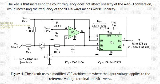

Posted: 12:53pm 17 Aug 2017
  Warpspeed said  A very convenient way to do that is to convert the battery current to a frequency that is directly proportional, with a voltage controlled oscillator...
If you have a cpu doing the measurement, another way is to use a voltage controlled pulse width generator and use the cpu's high speed clock to measure their width to determind a more accurate current measurement. See Article Here
This circuit runs off 5v and would be quite inexpensive to build.
Mike
Posted: 01:35pm 17 Aug 2017
Good one there Mike.
Straight conventional a/d conversion always suffers from reduced resolution at low input amplitudes, so is less than ideal for measuring over a very wide dynamic range.
If you wanted to measure individual milliamps and still have a 100 amp full scale range, it becomes difficult. You might need 100,000 bits of resolution. Maybe a 17 bit a/d converter which is going to suffer from severe noise problems if nothing else.
A 0 to 100Khz VCO, and then accumulating counts over an exact one second interval can do it easily, and also average out any noise over the one second measurement interval. So the result should be reasonably noise free in a noisy environment without requiring any further software averaging.
If you are really serious frequent auto zero correction and full scale calibration can be applied by a host microcontroller to correct for any long term drift.
Another advantage is that the output is only a single serial bit stream, so its very convenient if using an opto isolator (or wireless) or infra-red data link for a fully floating measurement. A 17 bit conventional a/d might require at least 17 opto isolators...
Voltage to period measurement has many of the same advantages and is sometimes much more useful. But both techniques are well worth knowing about.
