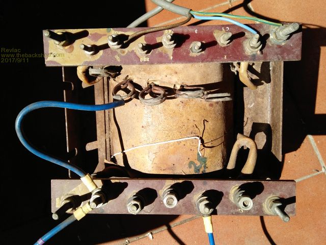

OK there has been a few inverters built using rewound toroids, quite impressive too.
Its getting a little more difficult to find toroids as most new GTI's don't use them, at least not large ones anyway.
There is some good size EI transformers around, if they could be put back to work doing something useful instead of tripping over the damn things or ending up waisted as scrap.
The idea was to try and get an EI Transformer with enough grunt to run the power tools in the shed, It will mostly run during the day so Im not too bothered about the idle current or the efficiency, but will try and get an acceptable amount that I can be happy with.
This is what I have found so far.
Transformer measured 1.06volts per turn buy running a small wire around the windings
core is 70X80mm Weight 27KG
Tested 50volts at the battery 235v on the AC side (driven by the EGS002 inverter)
current draw no load @ 27 volts on the primaries: no choke .913amp 46 Watts
on the 26 volt winding .850amp
with the E core choke 5 turns .685amp 34 Watts
now I did try the 25v winding and found a significant drop in the no load current, however there must be some point where running a low voltage through the primaries that its to low for the little EGS002 PWM to handle safely?
I have run various loads, water pump, small air con, large angle grinder, large fan and a freezer without a choke, the current draw (efficiency) was terrible.
But I must say when running with a choke the results where looking pretty good for average loads, at least as good as the High frequency inverter that is running the house ATM.
Its was some time ago when I tested this and haven't done anymore with it after blowing up a few fets and the 002 board, have so much other work to catch up with, hope to get back onto it soon.
Will Try again with proper current meter.
As this is a multi tap transformer there is a few different voltages to play with and see what turns out better, there is also another tap 300volts I think from memory, If I use that tap it would lower the volts per turn? Is there any benefit in trying that? Or just keep the turns ratio the same as the toroids are wound?
I don't really want to rewind this one as its good to play with for a bit until I get something a little bigger.
Aaron

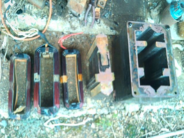

Now the next one is 200x50mm and a hefty 105Kg its from an old PSU for a computer system back in the 1980's probably even earlier.
Has 240v to 110v step down and a capacitor filter was connected to the winding on the left side.
The core is held in place with 2 bolts and would make rewinding the thing pretty easy If I decide to use it for an inverter.
Strange looking thing never seen anything like it before.
Perhaps there is a good reason for that.

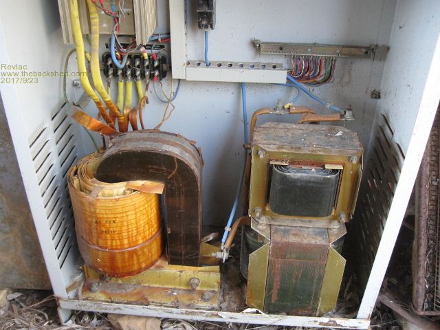

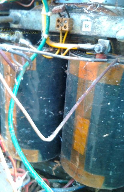

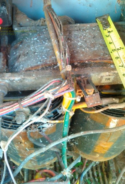

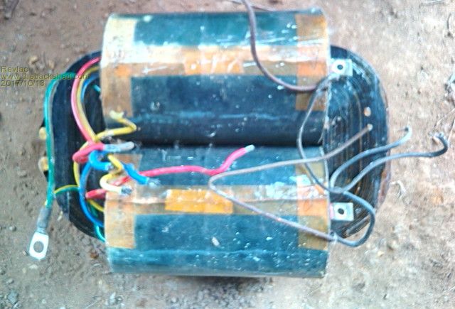

Revlac
Joined: 31/12/2016
Posts: 1309
Posted: 03:28am 23 Sep 2017
HI Warpspeed
I see you have no problem designing and building your own gear.
The changeover speed on some small ups these days (cheep 500w version I had) is not fast enough for some equipment, At 10ms transfer time, my old computer used to drop out.
Some local shopping centers don't have a backup geny or UPS, the grid went down and they just shut the door.
A few have industrial size UPS (Think the inverter transformer runs full time) Keeps the cash registers going.
These battery chargers used by Telecom were built strong and could connect up to 100 of them together if they had the communication wires connected.
This one is Power Electronics
charges about 50A, Have run it to 60A no problem provided I don't mess around with the current limiter, (Snaps the breakers off almost instantly) it uses a block SCR and Diode configuration very robust design IMO.
Have one identical to this, charges the lithium battery bank sometimes, noisy 80 decibels @ 1m.
The 2 different size chokes are huge.
The transformer looks like 2 horse shoes strapped together output is 80v.
Would be quite a large area to rewind a new secondary and primary on to it.
Has a large air gap between the primary and secondary ATM

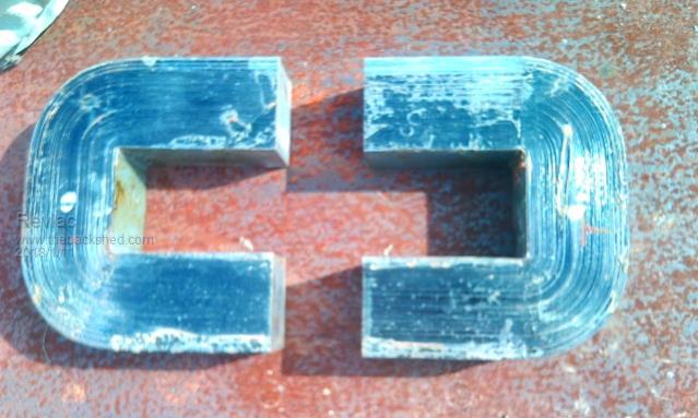

This next one Is L.M.Ericson much the same but more compact
pictures are a bit crappy from the phone camera.
Batteries in the good camera leaked and stuffed the inside of it.
Has smaller core area but they covered more of it.
I think theses core's may be worthy contenders.
Also have a transformer from a CIG 150 mig welder my only dislike about that one is all the laminates are welded together where as all others I have are bolted (clamped together)
Well Them's my choices
Aaron
Cheers Aaron
Off The Grid

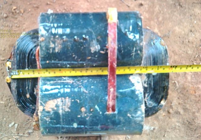

Posted: 03:10am 13 Oct 2017

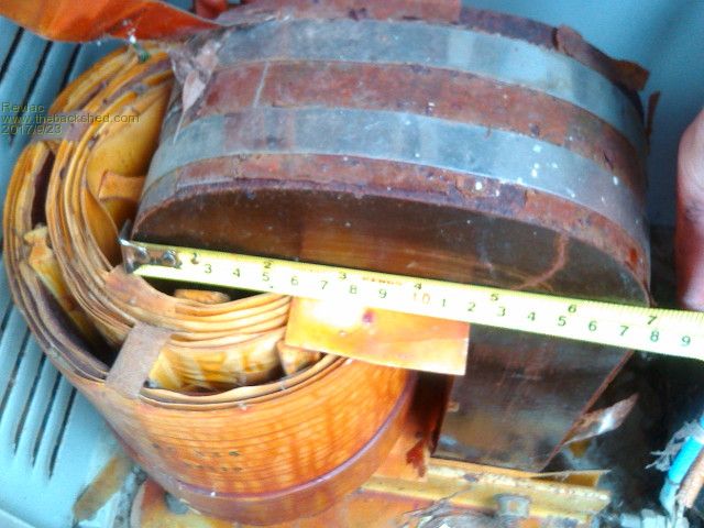

Finally managed to get that Big Transformer apart, thought it would be an easy job, just take the bolts out then slide the center out, But no! after stuffing around trying to press it apart with a jack, the middle leg would not move, stuck in tight with paint.
I ended up separating all the laminates just to free it up.
Anyway this is how it turned out, looks like a bit more work than I have time for ATM.
Core is 100cmsq
Volts per turn was 3.7
primary was 64 turns
About 1.5 Tesla
This is the calculations That I thought would be appropriate
For 48Volt by 235Volt
primary turns 14
Secondary turns 127
Tesla 0.833
Turns Ratio 9:1
This might have to go on the back burner for a bit.
I have this C core that should be a little easier start with.
For low idle current I'm looking at 0.575 volts per turn.
Core is 52x60mm
primary turns would be 45
secondary turns 405
Tesla .837
Again that is a 9:1 turns ratio, might work it down to 8:1 yet
Just depends on how that many turns will fit with the size of wire that I have.

Either of those C core transformers look promising, provided you can separate the two halves.
They will almost certainly be dipped in transformer varnish and then oven baked.
That effectively "glues" the whole thing into one solid lump, and sometimes they come apart fairly readily and sometimes they don't.
It may take something like a very large chain block, a sturdy metal frame, and several tons of force, but see how you go. Don't be too surprised if you cannot get them to come apart.
The ferroresonant transformer is completely useless for anything other than a ferroresonant transformer. Its junk.
